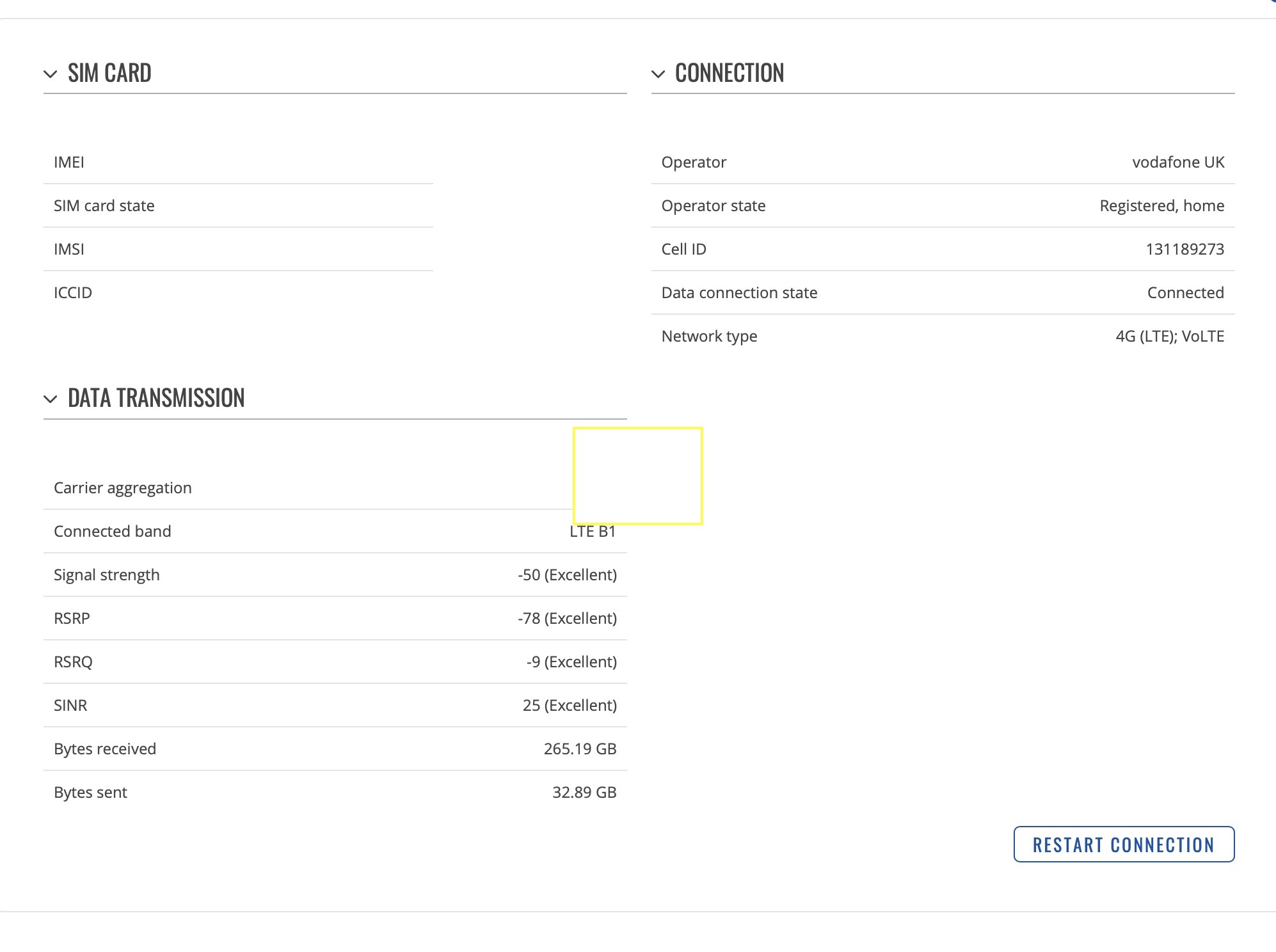

I will also ask you to (during normal operation) navigate to System → Network → Mobile and take a screenshot of this window. This will help me identify if the signal strength could also be an issue. Once again, make sure to blur out the IMEI, IMSI, and ICCID values.

I’ve just had a disconnection while at home so please see the log details below. Have also attached a screenshot of the mobile page. Signal is generally very good as I can see the cell tower directly from the modem’s position. It is roughly half a mile away from us.

Indeed, from the logs it seems like while the device is still connected to the carrier, it does not have a connection to the internet, thus the modem reboots to try and recover the connection.
Could you try disabling failover and/or ping reboot and check if the issue replicates?
Additionally, you could navigate to Network → Interfaces → General, edit the mob1s1a1 interface, disable the Auto APN, and insert wap.vodafone.co.uk as a custom APN. This will force the router to skip a few connection checks just so we can validate that there actually is no connection.
