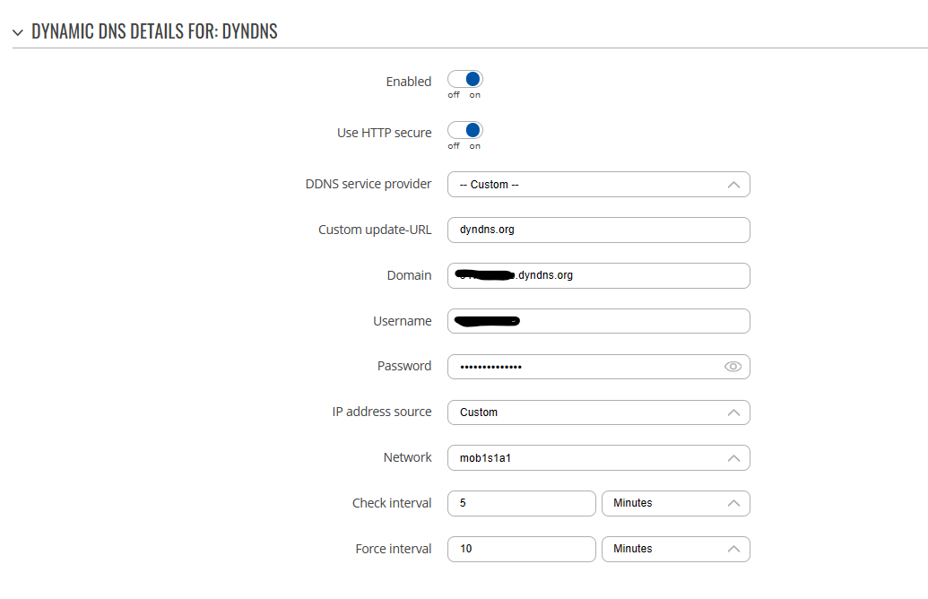

Screenshot below show DDNS settings - Hope this identifies an issue with the setup that may help??

Do you have a public IP on your mob1s1a1 interface? What are the first two octets of the IP address?
Also, could you try adding a DNS server to your mob1s1a1 interface? To do so, navigate to Network → WAN → edit Mob1s1a1 → Advanced settings. There, add 8.8.8.8 and 1.1.1.1 as the DNS servers.
Are you using any group names within your username?
Do you use the updater client key as a password? You should be able to find this key on the DynDNS website somewhere in the settings.
