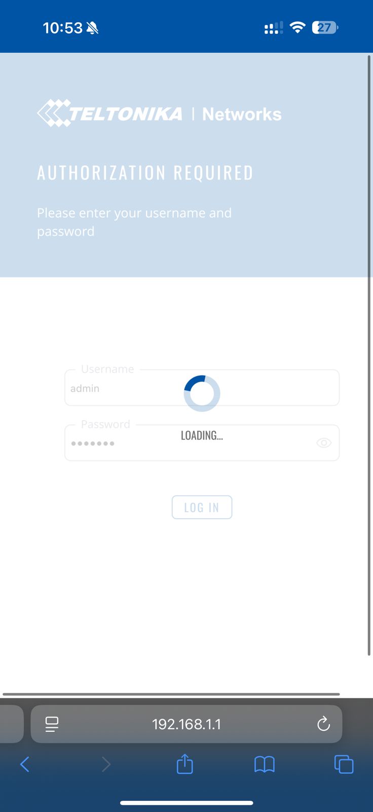

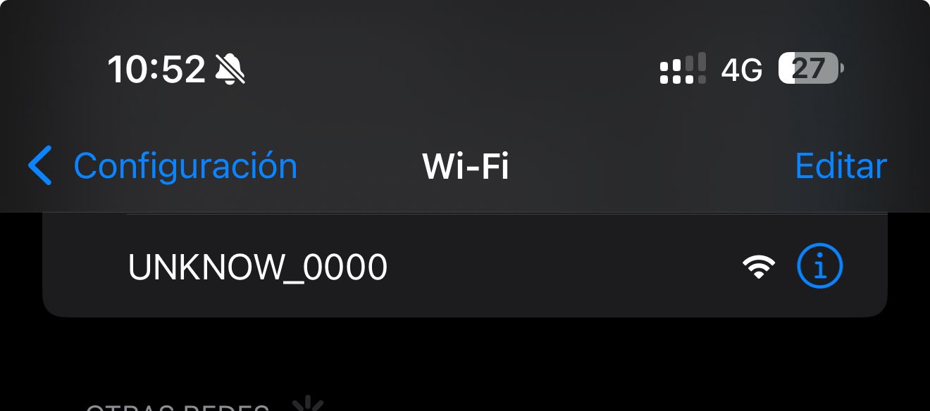

Recently,i reset my rut 240 router, but after some time, i just can´t connect to the network.
The wifi name changed automatically to UNKNOW_0000.
I saw that i can´t even log into the admin page by using the default password, because when i click the log in button i got stuck on loading, and nothing happens.
i tried updating the firmware and other ways to reset bootloader, but nothing solves my issue.
What can I do? because this router is essential for work.
Thank you in advance for your help. :blush:
