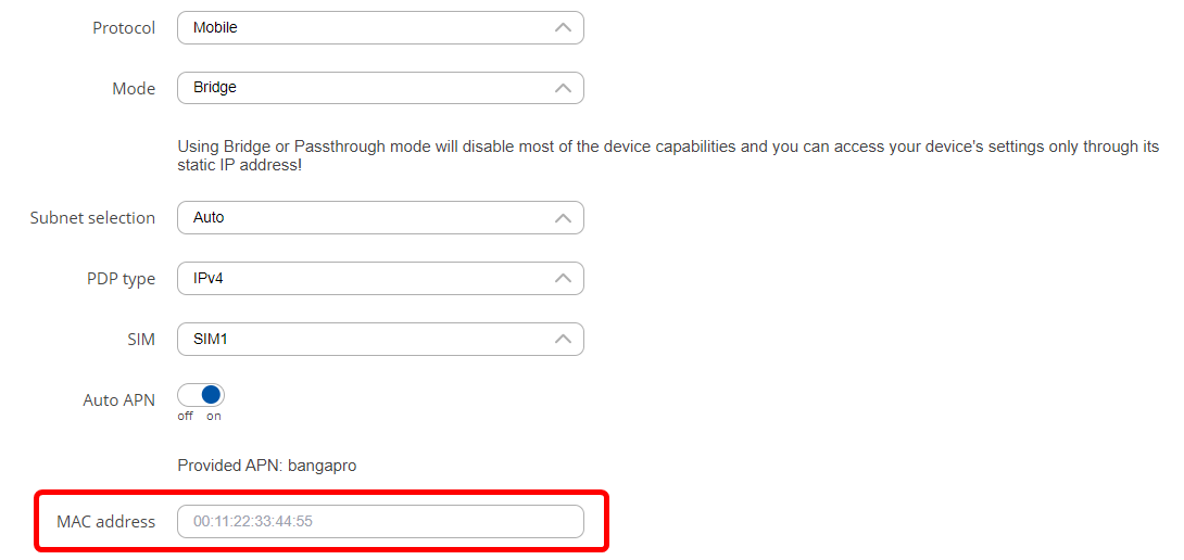

I presume what you are looking for is Passthrough/Bridge mode for both modems. If that is the case, Bridge mode can be enabled on both SIM interfaces, and the MAC addresses will need to be specified for each downlink interface. If this is the topology you’d like to achieve:
rutx12
Then when configuring mob1s1a1 interface, enter the MAC address of the WAN1 interface (AA:AA:AA:AA:AA:AA in the example):
The same needs to be done for the second interface, except the MAC address should be of the WAN2 interface (BB:BB:BB:BB:BB in the example). Make sure WAN1 and WAN2 has different MACs!
