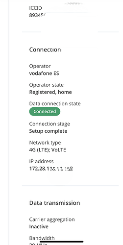

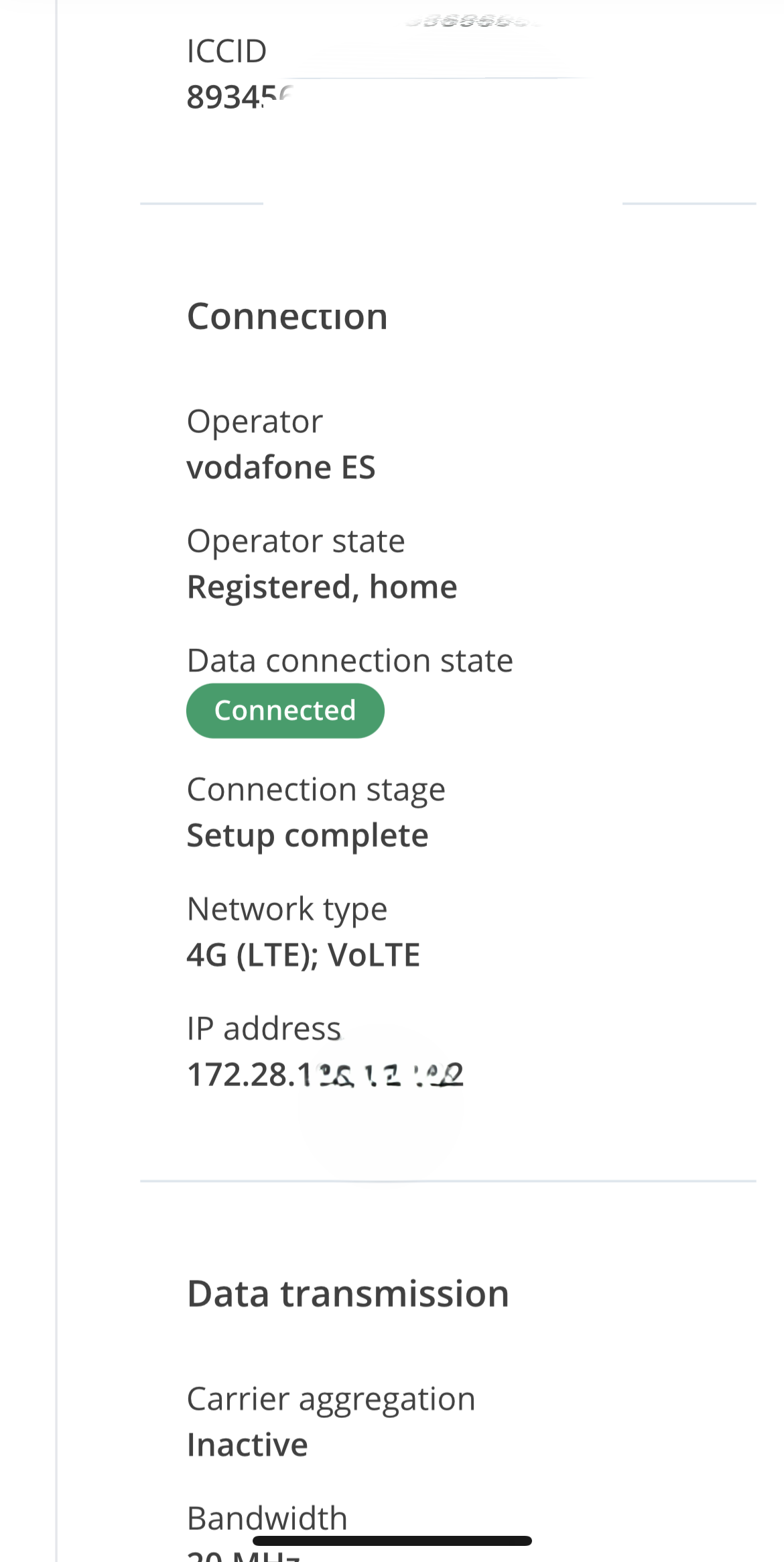

I use a 241 with a mobil Sim card. After a unespected black out is not able to provide internect collecion.

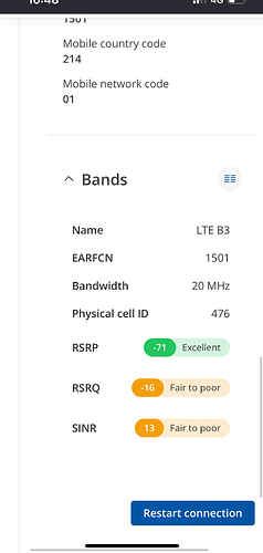

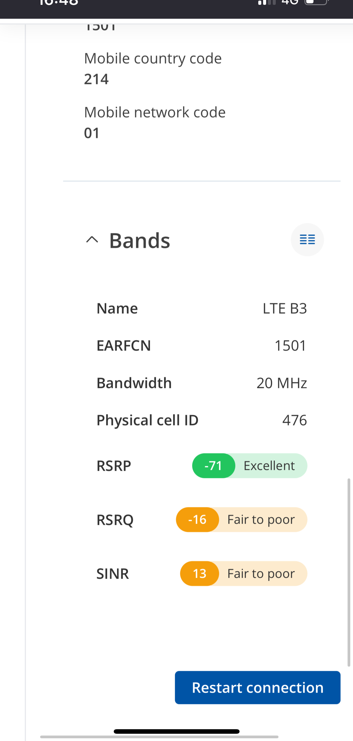

The sim card is working on other devices, and when inserted in the 241 the device reconize the sim, provide connection to vodafone, provide an Ip adress, reconize the network type. When looking ath the data trasmission sheet it show excellent RSSI, Carrier aggregation inactive. In Bans RSRP excellent, SPRQ fair to poor, as SINR.
No internet in the wifi or in lan. The router is in the same place and 4g signal is strong. Pin si correct. Data on sim are activated

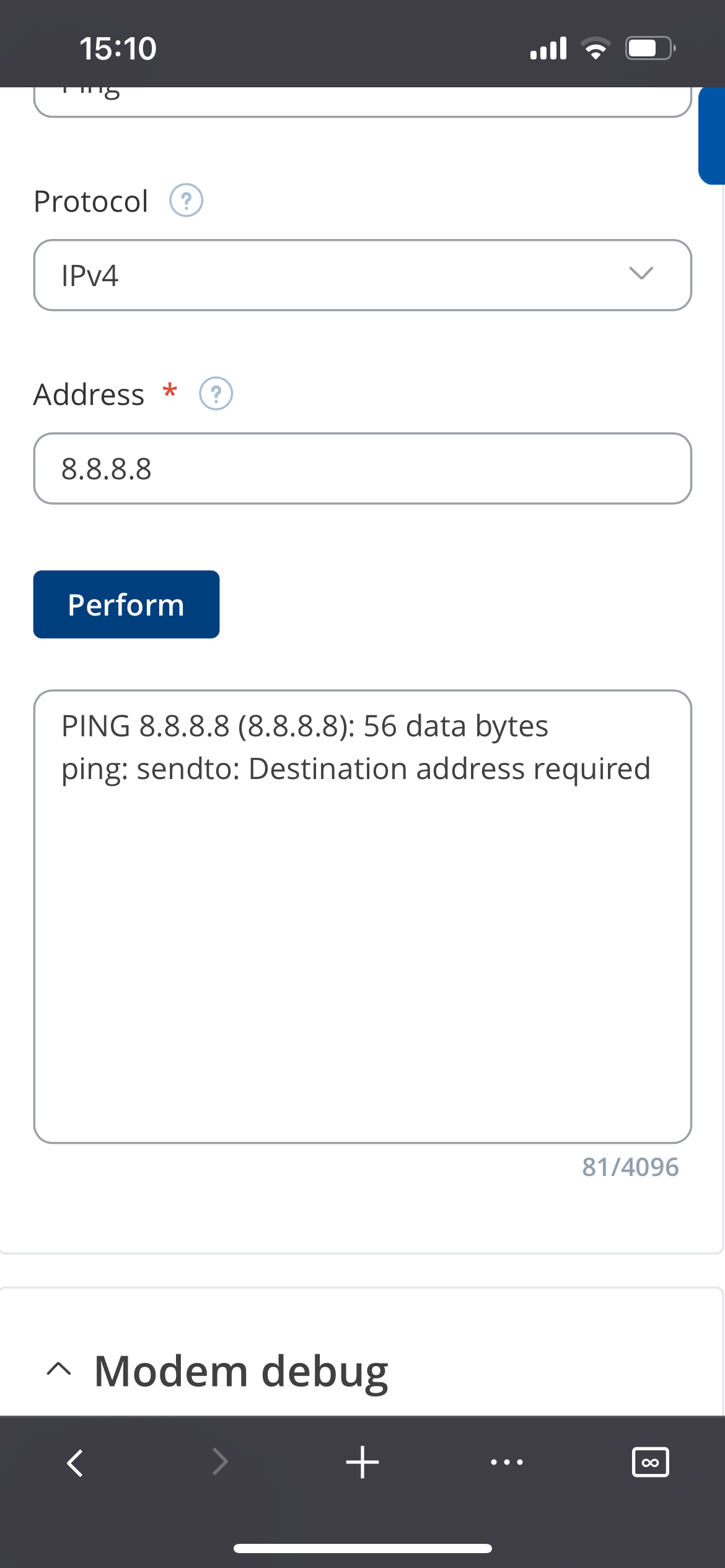

  2. Could you please check whether the router itself can reach the internet by using the Diagnostics tool (System → Maintenance → Troubleshoot → Diagnostics tab) and sending pings to 8.8.8.8?

Hi there. Changes as suggested were made
still no internet on the devices .
