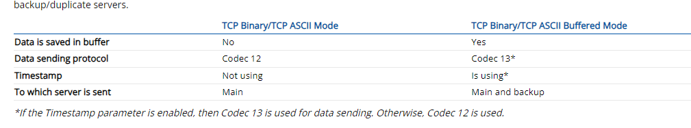

If you are using TCP Binary/ASCII mode the data will be sent via Codec 12 using this mode GPS location will not be available: Codec - Wiki Knowledge Base | Teltonika GPS (teltonika-gps.com)
If you are going to use TCP Binary/ASCII buffered mode the data will be sent via Codec 13 GPS data still will not be available but the time stamp will be available: Codec - Wiki Knowledge Base | Teltonika GPS (teltonika-gps.com)

If you want to have the GPS data and the IMU data in 1 packet you need to use special firmware kindly contact your sales manager if the special firmware is available for this use case.
