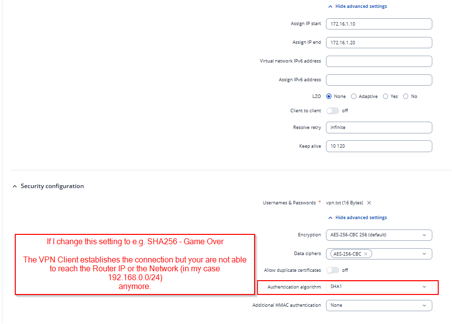

If you create an OpenVPN Connection with a “Push Option” e.g. “route 192.168.0.1 255.255.255.0” - so that you geht to your Router via VPN and you do not choose the “Security configuration - Authentication algorythm - SHA 1” you are able to establish a VPN Connection, but you do not get to your device or the network behind.
e.g. Create an Open VPN Connection with an authentication algroythm SHA256 and the VPN will connect but you end at a “Wall”. No possibility to get to the device or the network.
Change it to SHA1 - Everything works.

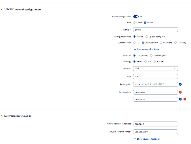

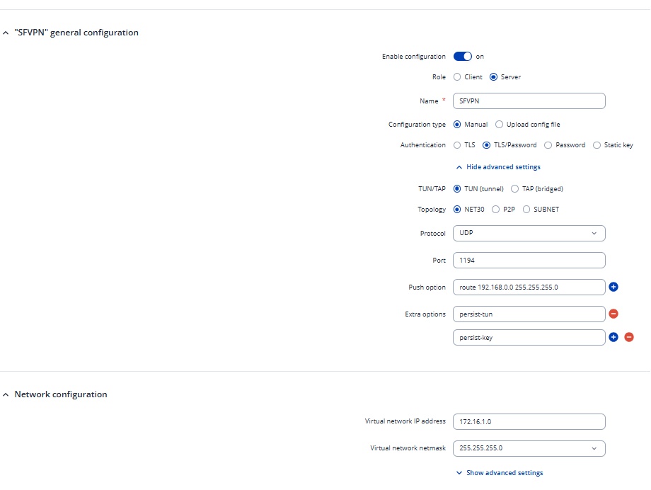

If possible, could you add a screenshot of the configuration?
I have to add some screenshots – its not possible in one screenshot

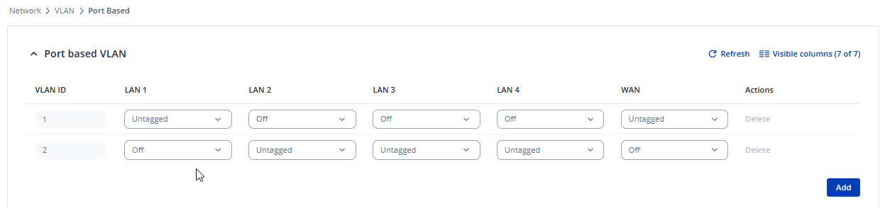

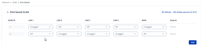

The Main Internet Connection is over SIM1 (mob1s1a1).
· I have 2 LANs
LAN1 192.168.0.0/24
LAN2 10.0.0.0/24
LAN1 is on Port LAN 1
LAN2 Is on Ports LAN 2- LAN4

  3. Routing: Currently, it appears the server pushes only one route to the client. Could you confirm which routes are pushed, and what routes appear on the client after connection? Without both LAN routes, the client won’t be able to reach the second LAN.

I tested everything once again and based on your reply I found the issue.
With SHA1 the OpenVPN Client file does not need any authentication settings.
If you switch to SHA256 you need the auth and cipher settings in the file.
So my Client File header looks like this now and that works:
