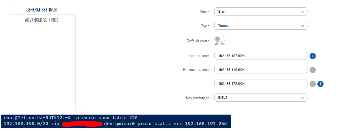

Hi, i cant get my routing to work over my ipsec VPN.
Setup:
I have about 60 RUT routers that all connect to my firewall.
All works fin as long as i only talks to one network.
In my test setup i have this configuration:
RUT--------------------------Other Firewall-----------------------RUT
192.168.197.0/24 192.168.172.0/24 192.168.140.0/24
If I have the 192.168.140.0/24 first then I can talk to that network
If I have the 192.168.172.0/24 first then I can talk to that network
But not both at the same time.
The routing table will only populate my first remote subnet:
What am I missing or is it a bugg.

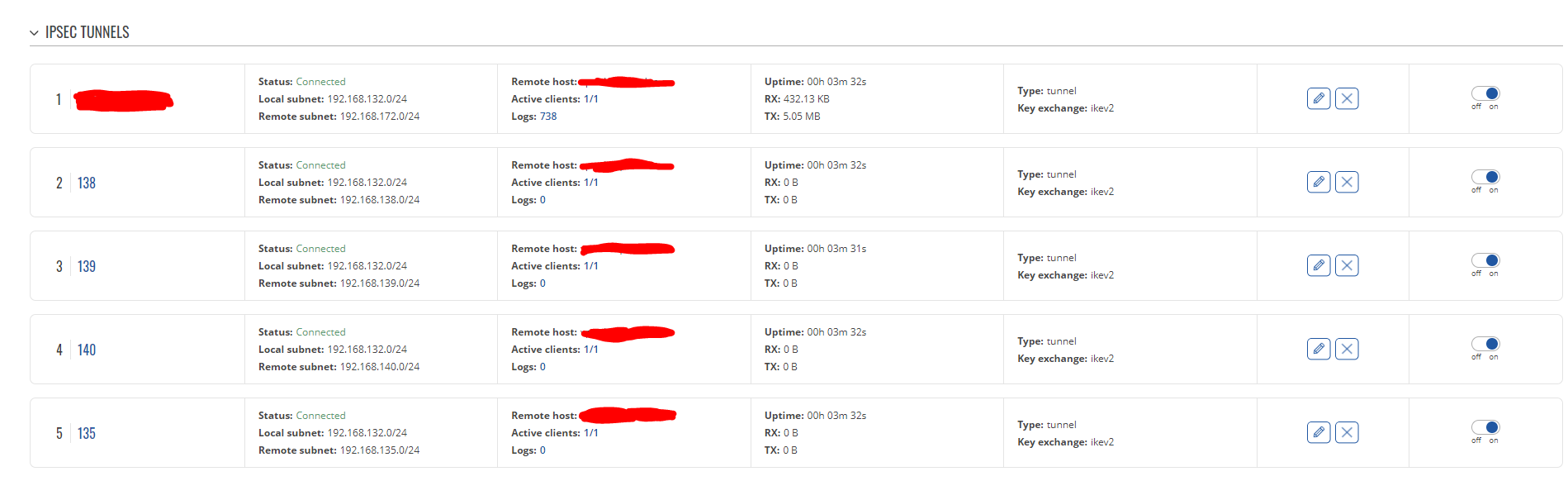

I managed to solve it by adding one vpn for every remote network. It works but in not a good solution.
