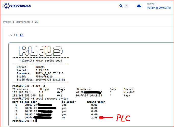

b) The Layer2 (TAP) VPN isn’t working for me, even if I try on the PC with the App working. It finally connects, gives my PC an IP from within the VPN, but if I try Layer 2 (using TIA-Portal to search the net, it doesn’t find anything.
Maybe this helps: I marked the last line “PLC” - this is the device I want to reach via Layer 2.

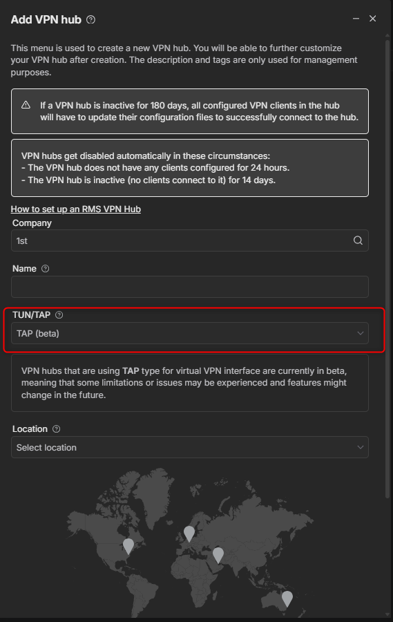

RMS VPN hub is based on OpenVPN, therefore, it should work. Could you please clarify if you’re setting it up in TAP mode?

I logged into the RMS platform and started the “TAP VPN hub”.
