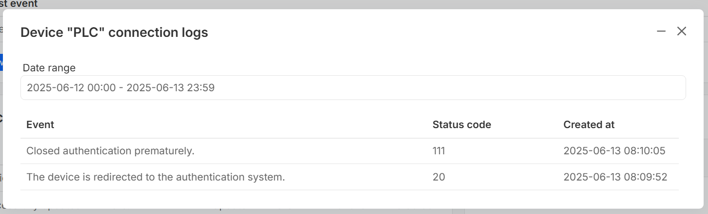

We have an RUT200 deployed remotely and forgot about it for about 2.5 months and the credit ran out for the RMS backend.
I have refreshed the credits and assigned them to the device, I done this yesterday.
Now today I gotten the above connection attempts, I cannot however work out what this means. What are the next steps to attempt to re-establish connection to the device and RMS?

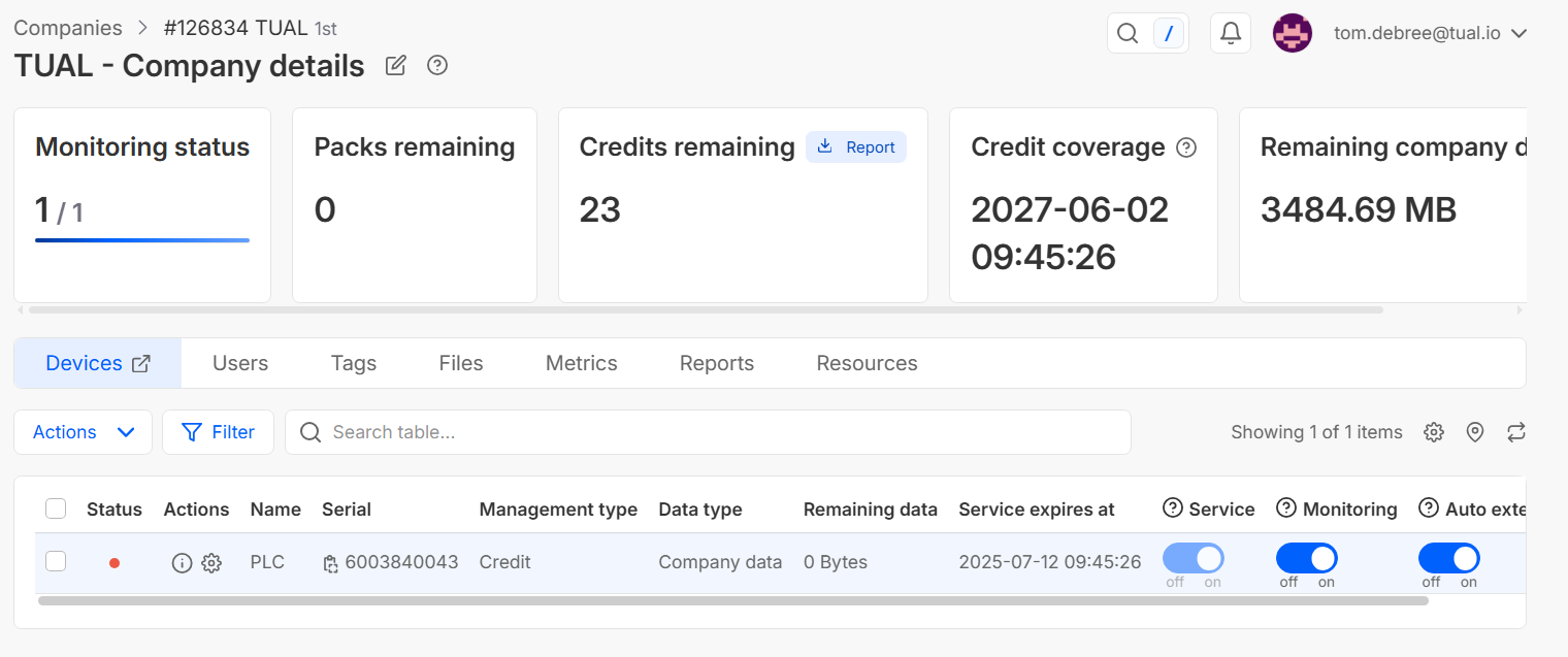

In RMS it shows the device has zero data assigned but the company has plenty left, does the data automatically get used by the device I cannot see how to allocate it.
The Remaining Data value is displayed next to a specific device when a Data Pack is assigned to that device. For example, if you purchase and assign a 150 GB Data Pack to a device, you will see “150 GB” listed as the remaining data for that device.
If no Data Pack is assigned and device uses data from Credits, the Remaining Data field will instead show the total remaining data available for the entire company, which can be used by any device.
More information is available in our wiki article: Difference Between Credits, Management Packs, Connection Data Packs, and Company Data
