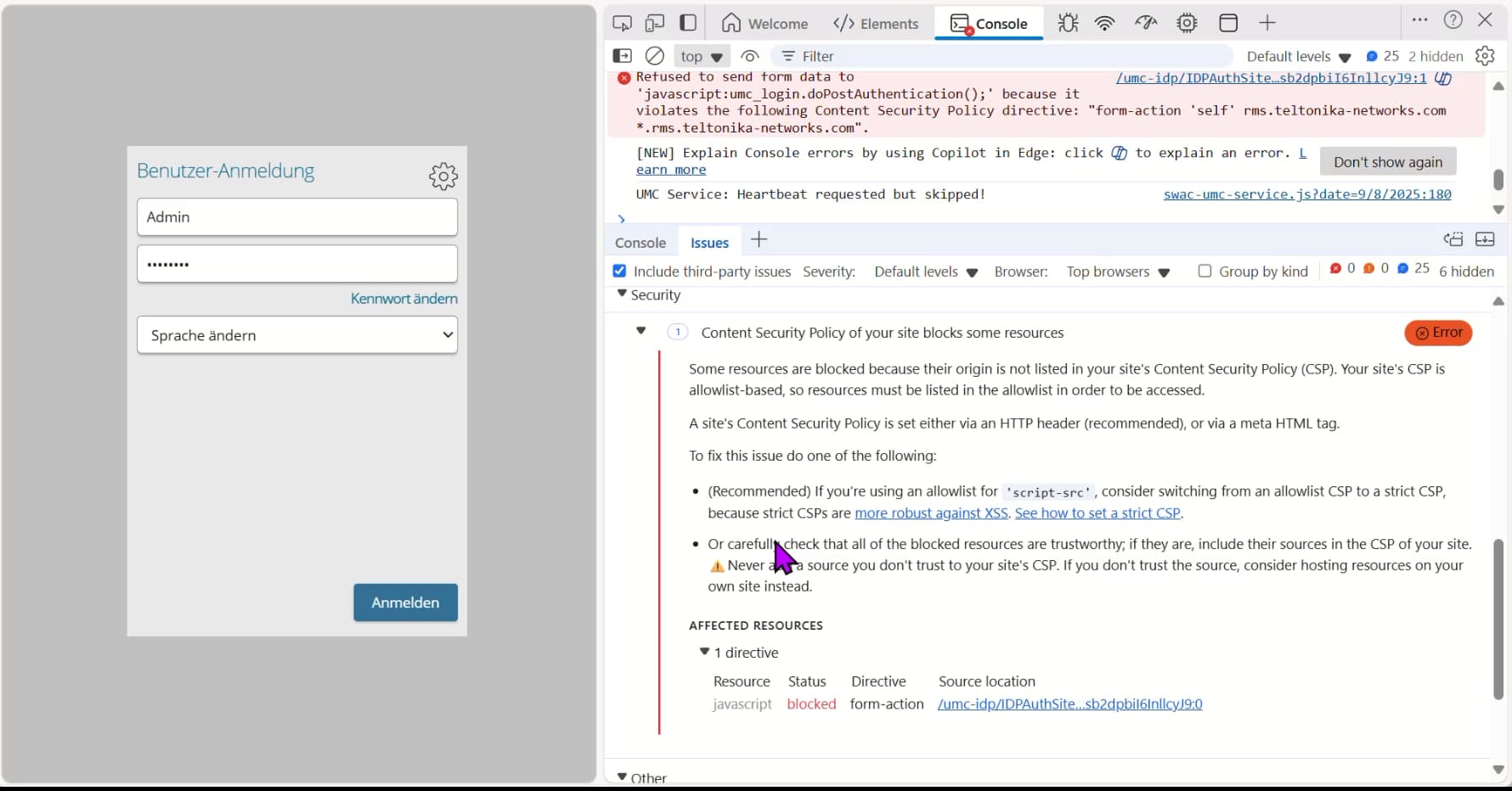

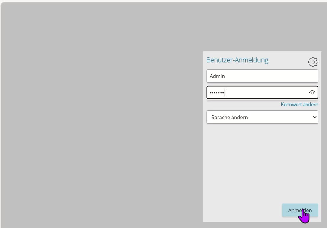

Hi, I am trying remote access on a SIMATIC Unified Basic Panel. It connects, works until after authentification. After clicking “Anmelden/Login” nothing seems to happen. I start Browsers dev console: Theres an stopping further progress.
I wonder if anybody saw this before - and knows how to solve this ?

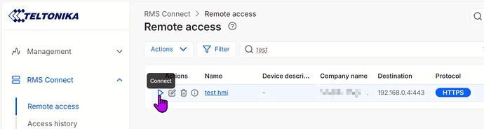

5-this-Url-was-used
