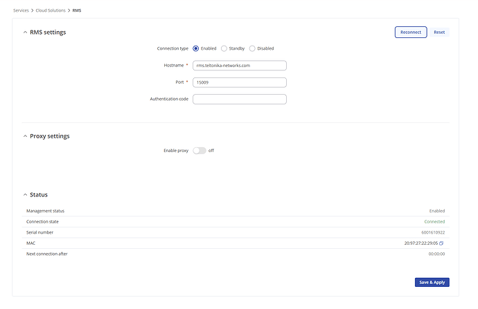

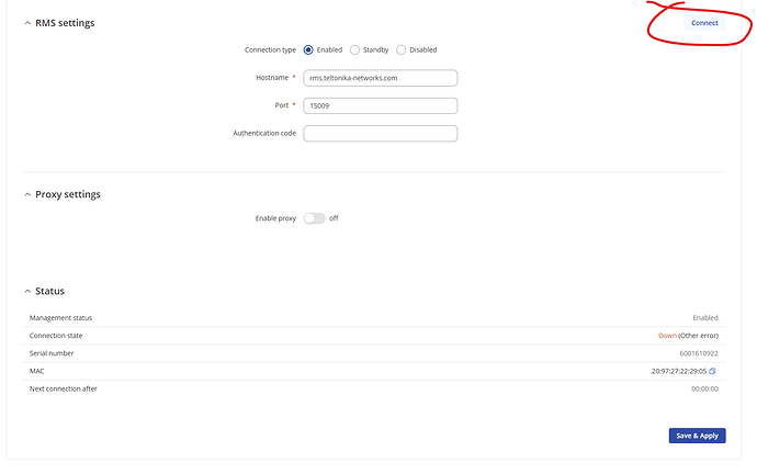

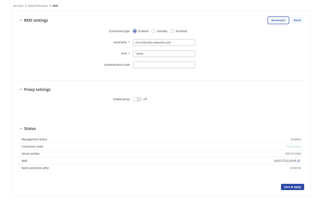

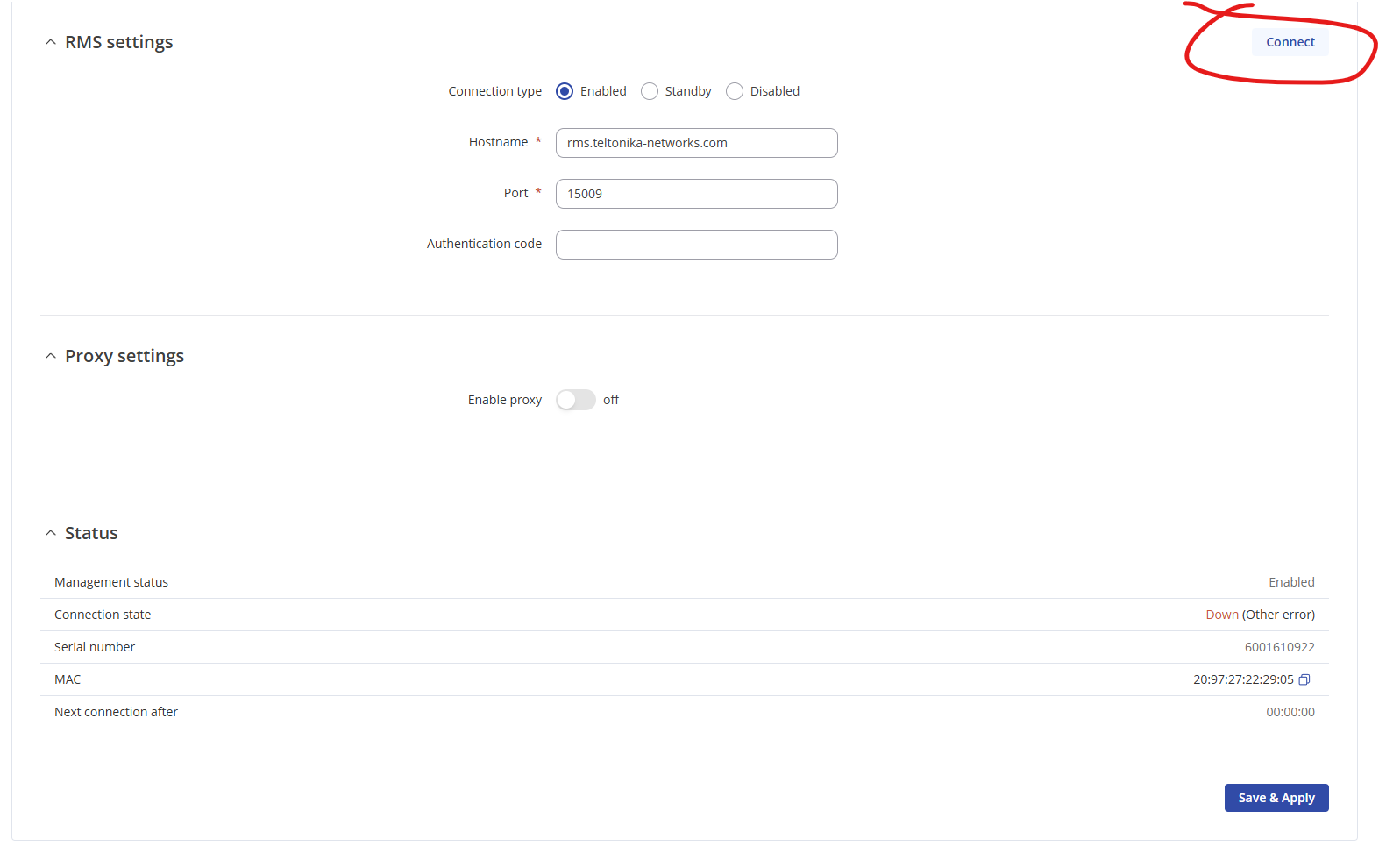

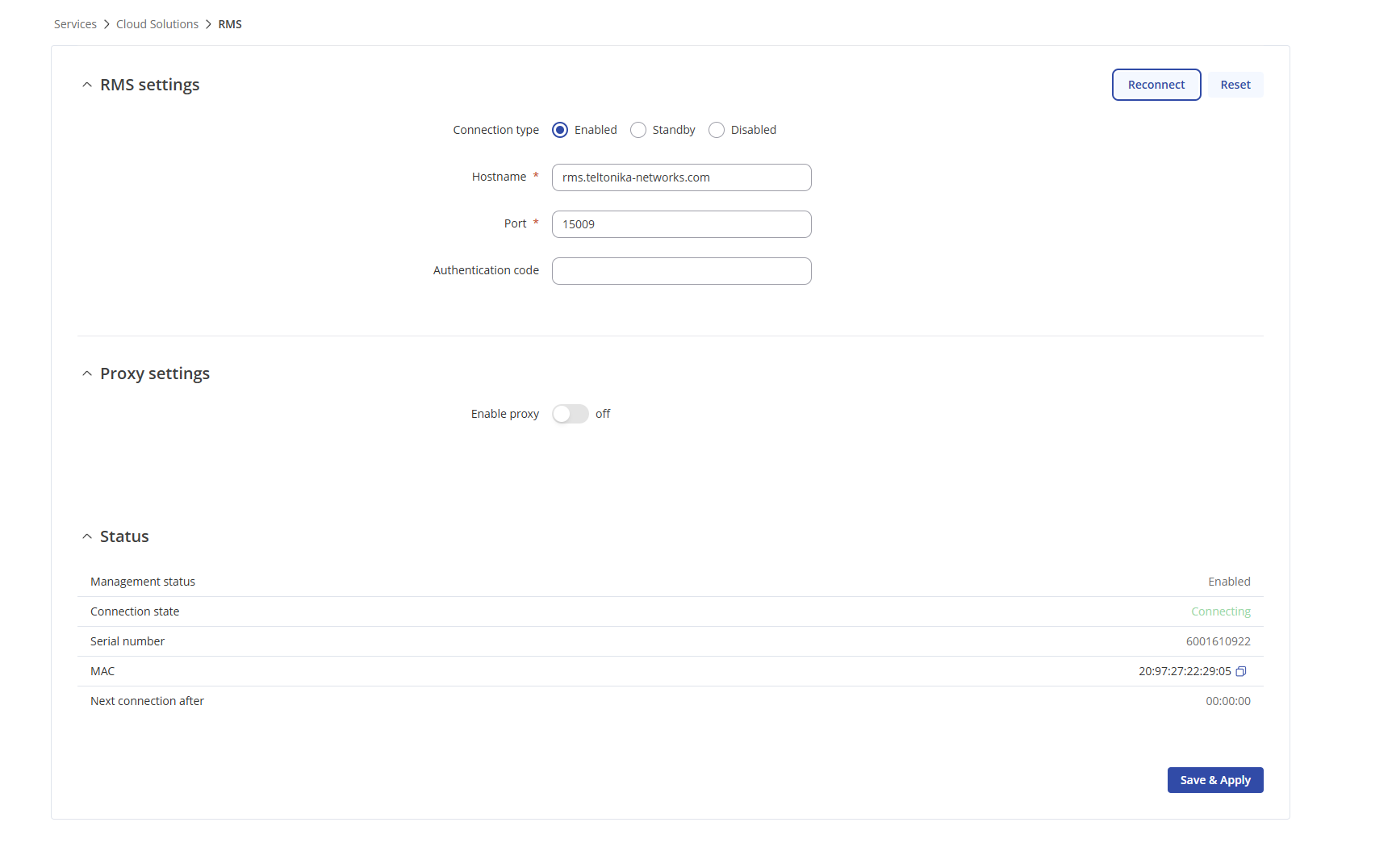

I’m using several TRB255/256 and TSW202/212 devices. I have a similar issue across all of them as well as across multiple firmware versions. During initial startup or after an internet outage the RMS service shows “failed to resolve HOSTNAME” or a similar error. It appears if RMS DNS lookup fails even once the service stops attempting to connect again? I have to manually remote into the devices and hit the connect button to initiate the connection again. @Marija This is an older firmware but the device that is currently in error.

@Marija Yes I understand that the error means the DNS name could not resolve and the internet was briefly down. My issue is that when the internet connection returns the device continues to stay down in RMS requiring a MANUAL reconnect in the GUI. This issue is ubiquitous across all firmwares even the most current.
