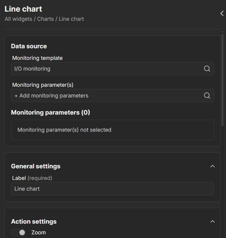

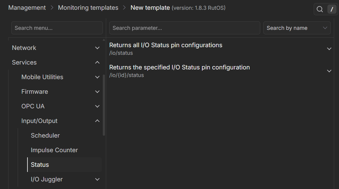

Setting/resetting is not an option, however, monitoring the data is possible by creating a custom monitoring template as you can see below:
Same can be done with those same dashboards:
