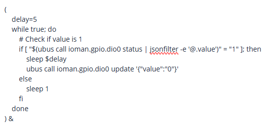

Script:
# Reset relays TRB256
#!/bin/ash
delay=5
while true; do
if [ “$(ubus call ioman.gpio.dio0 status | jsonfilter -e ‘@.value’)” = “1” ]; then
sleep $delay
ubus call ioman.gpio.dio0 update ‘{“value”:“0”}’
else
sleep 1
fi
done
Script was added as a workaround for an event juggler issue. I have an event juggler configuration where the control output is automatically reset after 3 seconds.

Could you please try wrapping the script in parentheses and adding an & sign at the end? This will force the process to run in the background, allowing the system to finish starting up and connect to RMS.
It should look like this:
It seems the current script causes the device’s boot sequence to hang. Adding the & sign starts the process in the background, which should resolve the issue.
Thanks for the suggestion — adding parentheses and the & at the end of the script seems to have resolved the issue on my test device. RMS now reconnects automatically after reboot.
