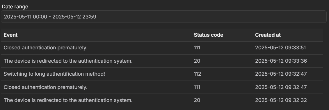

I have a bunch of routers and a lot of them are running different firmware versions. I am now having an issue with most of my routers where they wont connect to rms. Even when sending a sms command to connect I get the following on rms:
The routers have signal as they are sending data to my database very consistently.
I have tried every firmware from 7.11 and onward, but not one has fixed the problem.

I have experienced it with around 5 devices so far.
I am not sure, but the issue started around the time when I disabled auto extend for the management services.
For the Sms I received the following:
Disconnected, SSL Failure
Disconnected,
And Disconnected, RMS Connection Refused.
I have managed to get one of them to work again by rebooting it via sms, but to do this every time would not be ideal.
