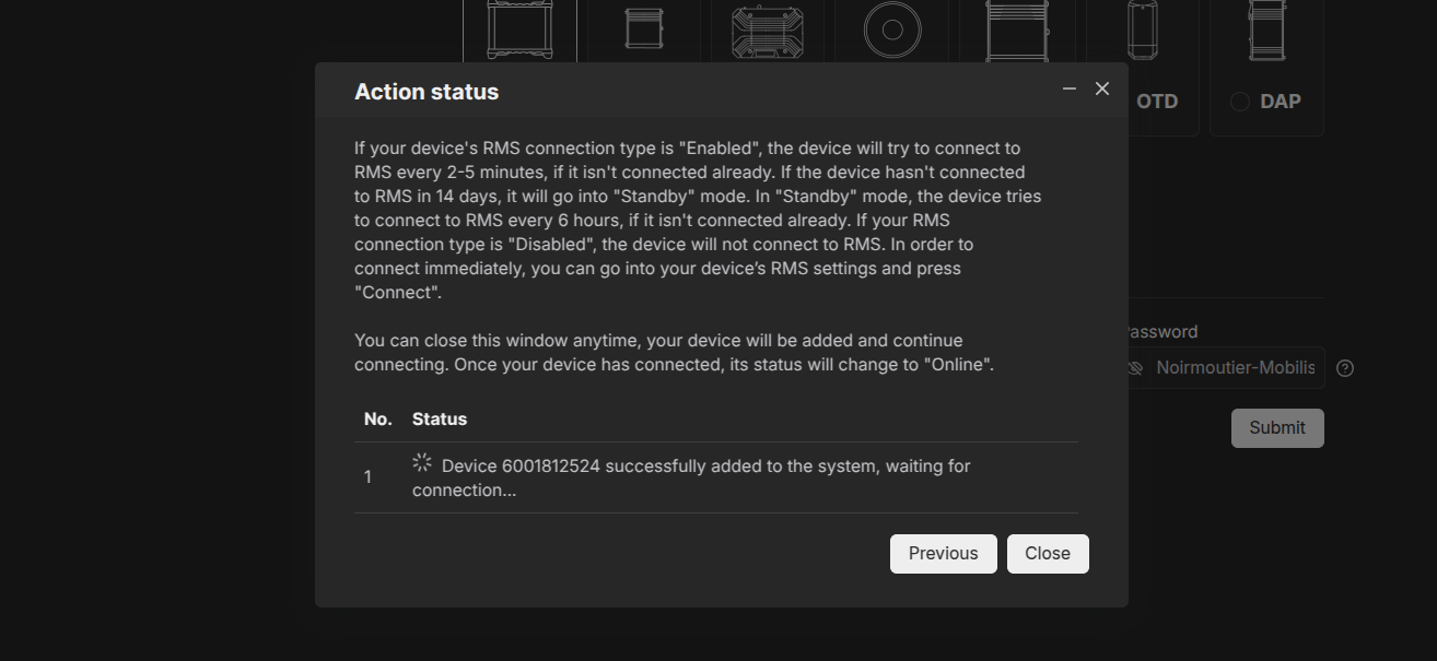

I have unregistered the devices and when I try to register it back it hangs here:
So now the device appears as Not activated in my RMS account.
