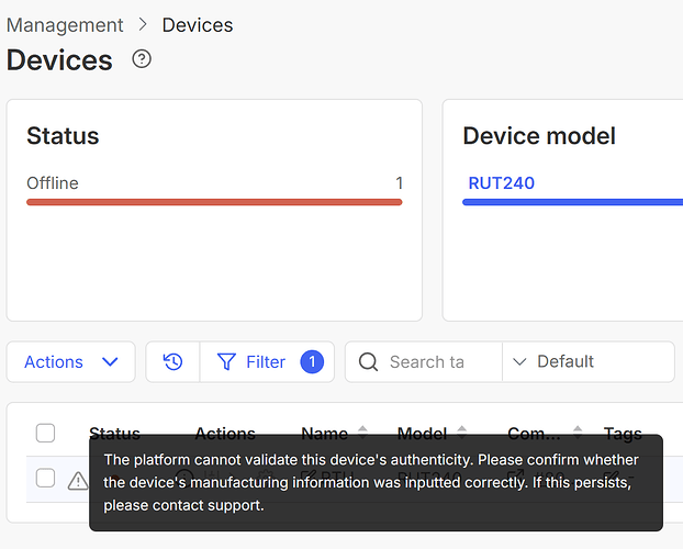

The platform cannot validate this devices authenticity. Please confirm whether the devices manufacturing information was inputted correctly. If this persists please contact support.

This is usually due to the fact that the serial number, MAC address, or IMEI was inputted incorrectly when registering the device. You are OK to unregister the device; nothing major will happen, but make sure that when you register the device again, you’re entering the correct details.
Another big thing is with the password when registering, some users tend to insert their RMS account password, which is not correct. You must enter the current device password that you use to log in to the WebUI of the said device.
Let me know if it goes well, I’ll help you out,
