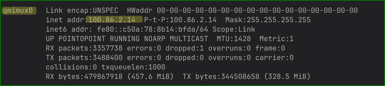

But ifconfig qmimux0 clearly shows an IP:
