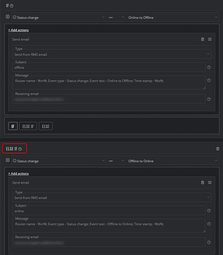

I’ve tested the Status Change Alert functionality, and it appears to be working as expected. To further troubleshoot your issue, could you please:
  1. Provide a screenshot of your status change alert template settings with sensitive/private information hidden?
  2. Check if you have the ELSE IF condition configured correctly in your alert settings?

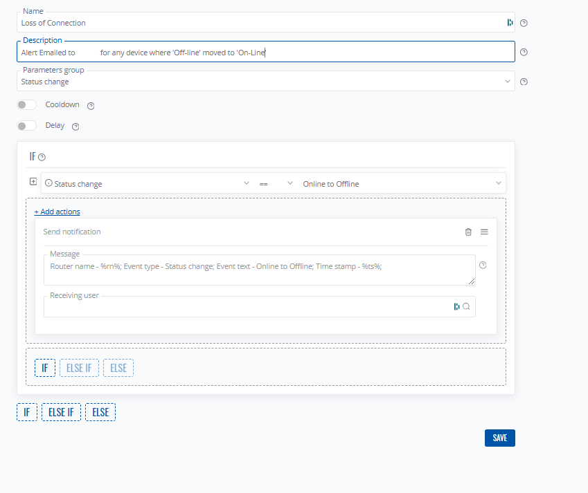

I have selected ‘send notification’, please see below. With this I select a user, rather than type in an email.
I will also test the different configuration you have in your screenshot, but how so I send this alert to multiple people?

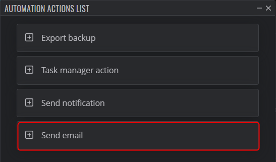

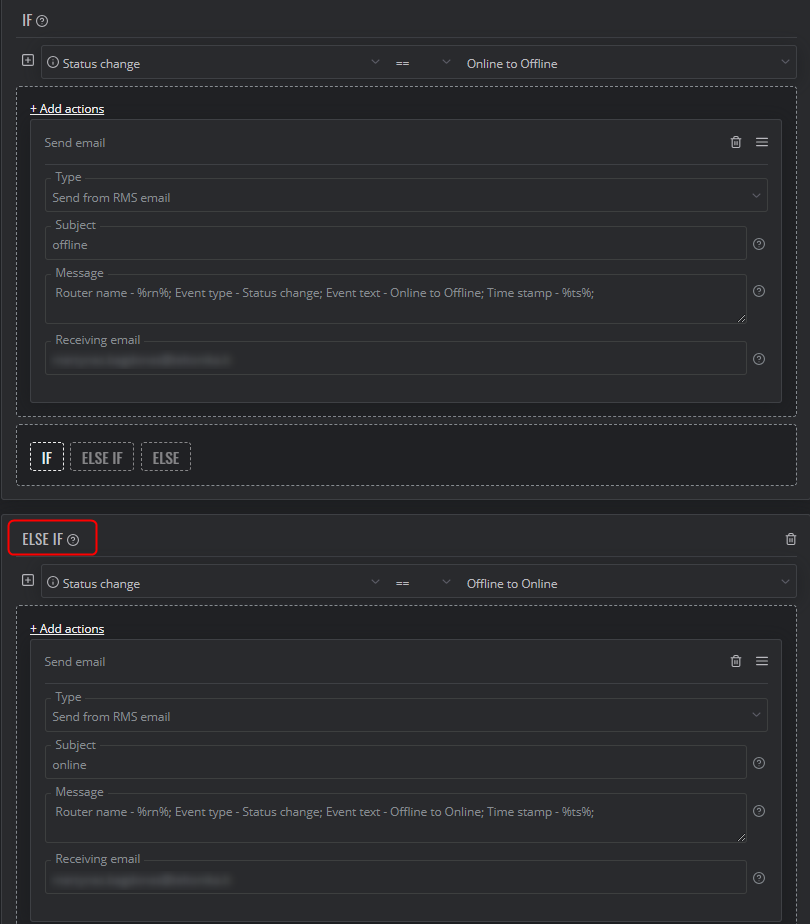

Just to clarify, the “Send notification” action will not send an email to the selected user—it will only display a notification in the Notifications section for that user. If you want the alert to be sent via email, you should select the “Send Email” action instead:
If you have any additional questions, feel free to ask.
