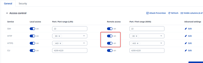

If your device has a public IP address, you can also access it remotely. Make sure that the remote access option is enabled on the router. If you have access to the WebUI, you can check this by navigating to System → Administration → Access Control and confirming that HTTP and HTTPS access are enabled:
