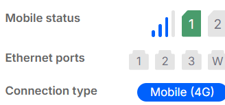

You can check the active connection status in different ways. One of them is checking in our RMS system, if you decide to utilize it. If you go to device details, you will be able to check which internet connection is currently active :

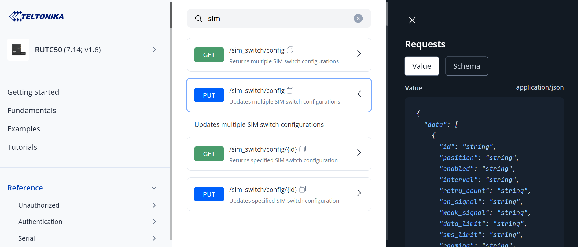

But one Information we have not found. How is the API command to switch the sim cards or change the connection priority? Is there also a API SET command to?
Depending on the API commands you need, I believe you can achieve what you are after with these ones (See screenshot)
