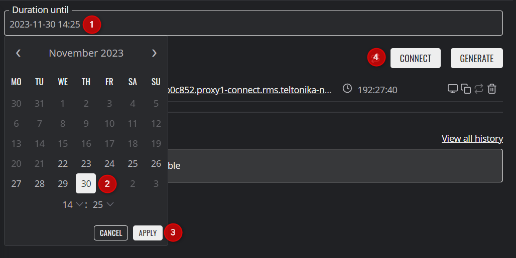

Ok, thanks. Its in the RMS connect service that i’m trying to generate the lnk. It will let me generate one but only for 30 mins or so. How do i change the duration?

In order to generate a longer duration RMS Connect URL, open the Remote access instance, select the date for how long the link should be active, and press the Generate button (not connect!):
Ah! amazing! Easy once you know how!
Thanks for your help, very appreciated.
