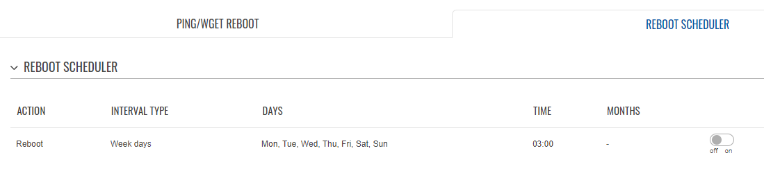

I have configured a reboot week day at 03:00 AM.
After a few day I select off on scheduler, but a router ad 03:00 AM reboot: why ?
I was unable to replicate this issue. When the rule was disabled, the router did not reboot.
When you disabled the rule, are you sure that you pressed the ‘save&apply’ button? Perhaps you forgot to do so?

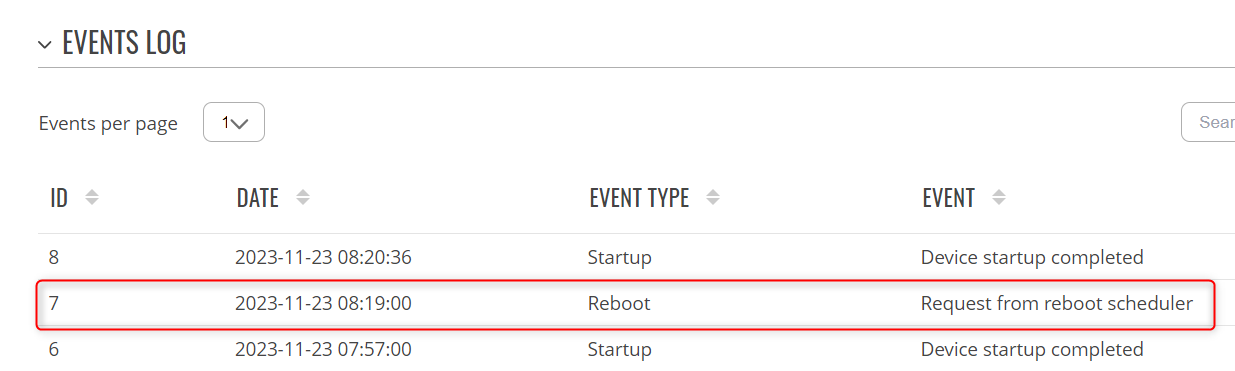

Are you sure that the router restarted because of the reboot scheduler? Could you please navigate to System → Maintenance → Events Log → System Events tab and check if the reboot was caused by the reboot scheduler? If it was a reboot scheduler, you should see an entry around 3:00 AM similar to the following:
I deleted action in reboot scheduler, rebootted router. In this moment router not rebooted ad 03:00 AM
