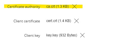

Hi.
I need to be able to read the certificate authority for an existing router RUT 241.
Is this possible? If so, where or how can I see this?
Thanks for your feedback
Hi.
At least on latest firmware certificates directly uploaded to config can be seen in /etc/vuci-uploads/
. Files there have prefixes so it will not be just ca.crt
Using console you can check detailed certificate info using openssl
e.g: openssl x509 -in /etc/vuci-uploads/cbid.wireless.default_radio1.ca.crt -text -noout
(just change file name)
