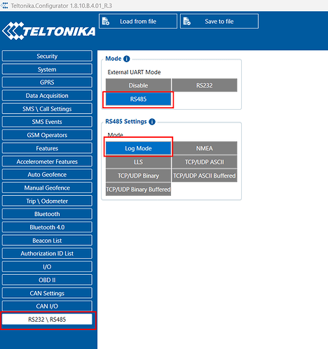

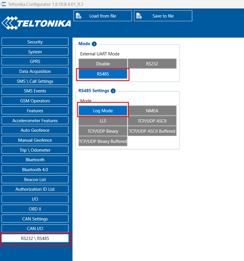

Dear Shahnawaz,
In FMB125, you can use the Log Mode in RS232 or RS485 to send the data to a PC.
However, as mentioned earlier, the received data will be in ASCII format, and you will need to parse the records from the live log accordingly.
Please find the attached screenshot for your reference.
