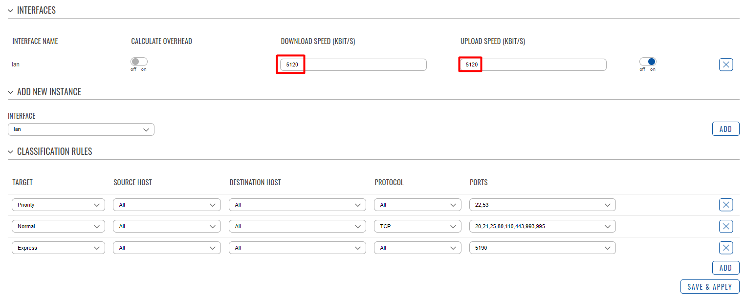

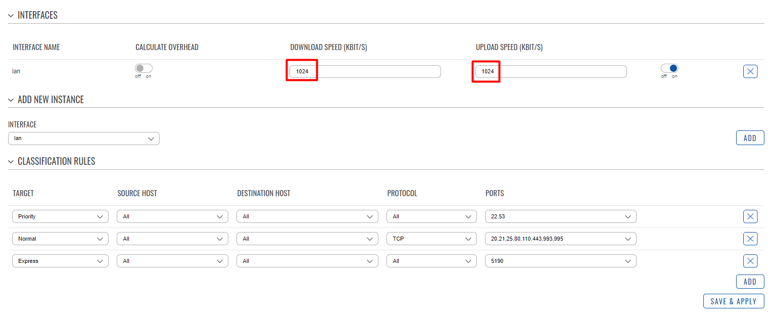

When I used QoS in my use case, it is by default on 1024 kbps settings. That is why when you check the speed of your LAN device, it will show around 1 Mbps Upload / Download speed. You can see below some screenshots for references:

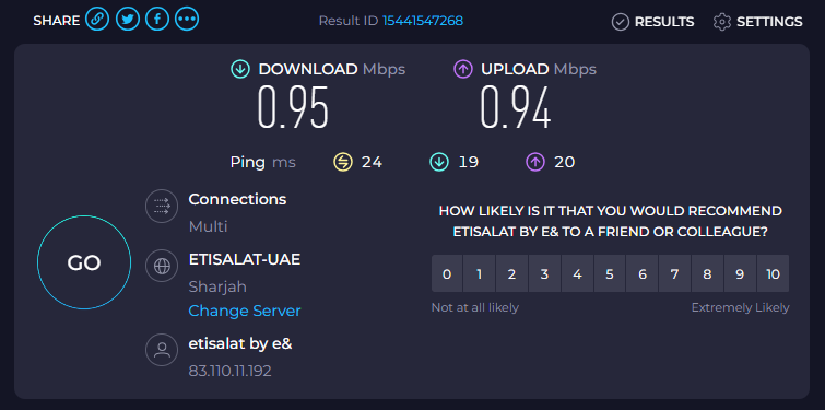

1024 kbps Upload/Download
Results in speedtest.net (around 1Mbps speeds)

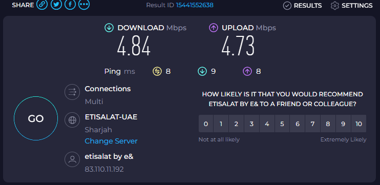

5120 kbps Upload/Download
Results in speedtest.net (around 5Mbps speeds)

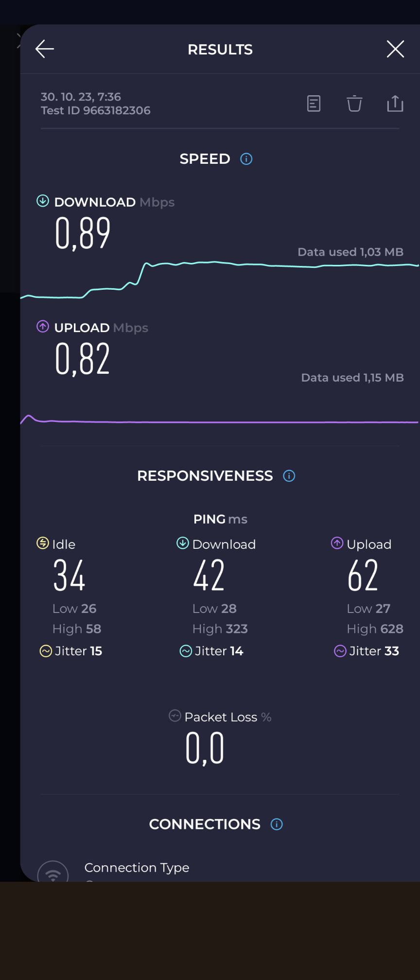

Speed test results with QoS:

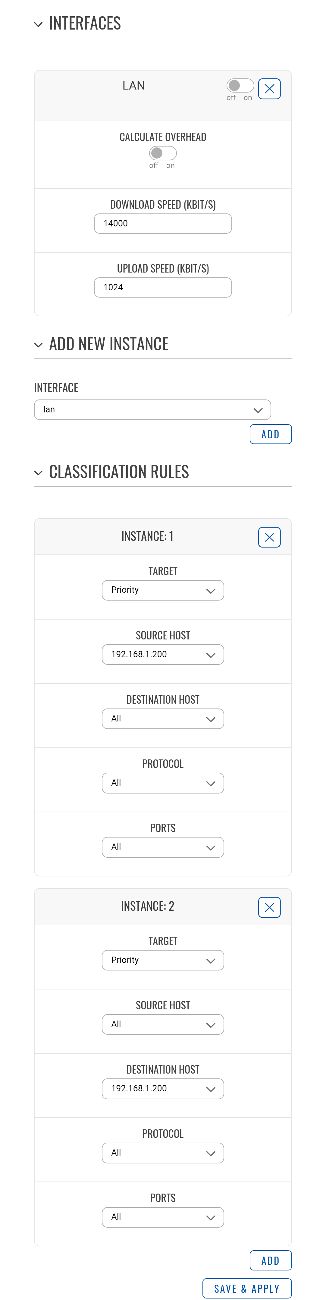

Could you post screenshot(s) of your configuration of SQM/QoS?
Thank you.
Sure.
I forget to mention it, but I use WAN port as LAN port.
The interfaces option is used for limiting bandwidth of a specific interface. In your case, you have configured the maximum speed for the LAN interface, meaning the hosts of this network will not be able to achieve speed higher than that. However, the rule is not enabled, so it will not do anything.
The classification rules specify which hosts/protocols/ports should be prioritized. If you’d like two hosts to have priority, you should configure them (as you have done), but you’d also need a rule with Normal priority for the rest of the hosts. The simplest way I could come up with to check whether the priorities are working, would be to run a speed test simultaneously on two hosts - one with Priority target, and another with Normal target. The host with a higher priority should achieve better speeds.
