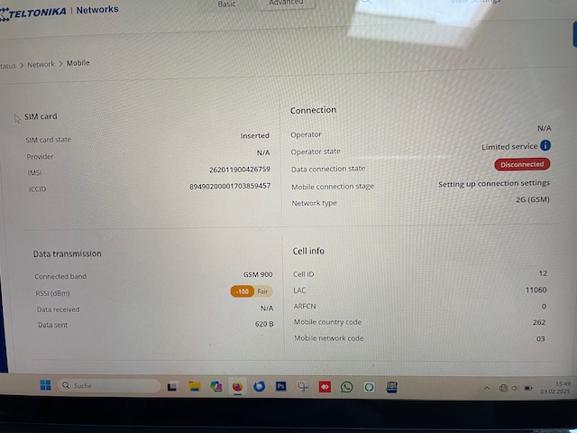

  • Could you provide a screenshot from Status → Network → Mobile?
  • Please also ensure that the antennas are properly screwed in.
  • Could you provide any connection related logs from System → Maintenace → Troubleshoot System log → Show section?

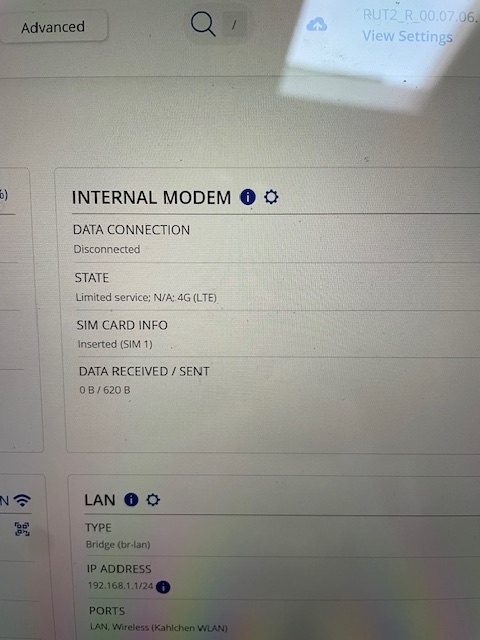

I have a PIN code and it is the correct one. Tested in mobile phone.

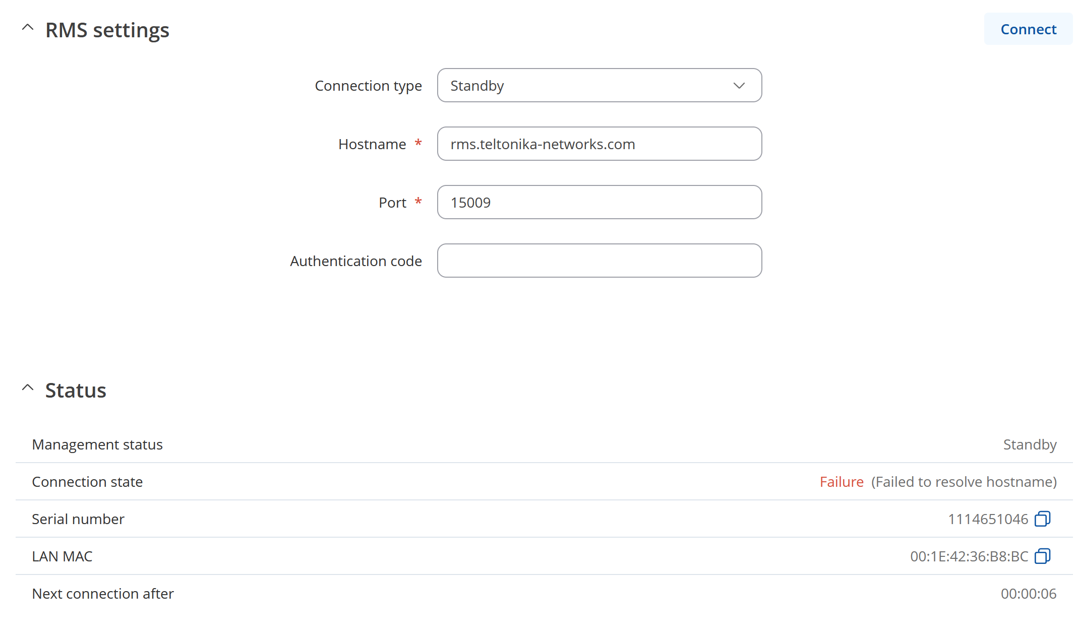

Send you pictures an a log file.
Cannot send log file because TXT not allowed.
See here:
and short after connect:
After 3 seconds shows at “Connection state” again Failure.

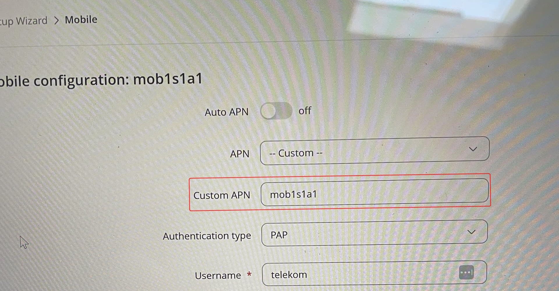

It appears that the issue might be related to an incorrect APN specified in the Network → Mobile settings:
Could you please select the correct APN and restart the connection through Status → Network → Mobile?
I hope this helps, and if you need further assistance, feel free to reach out.

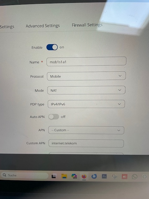

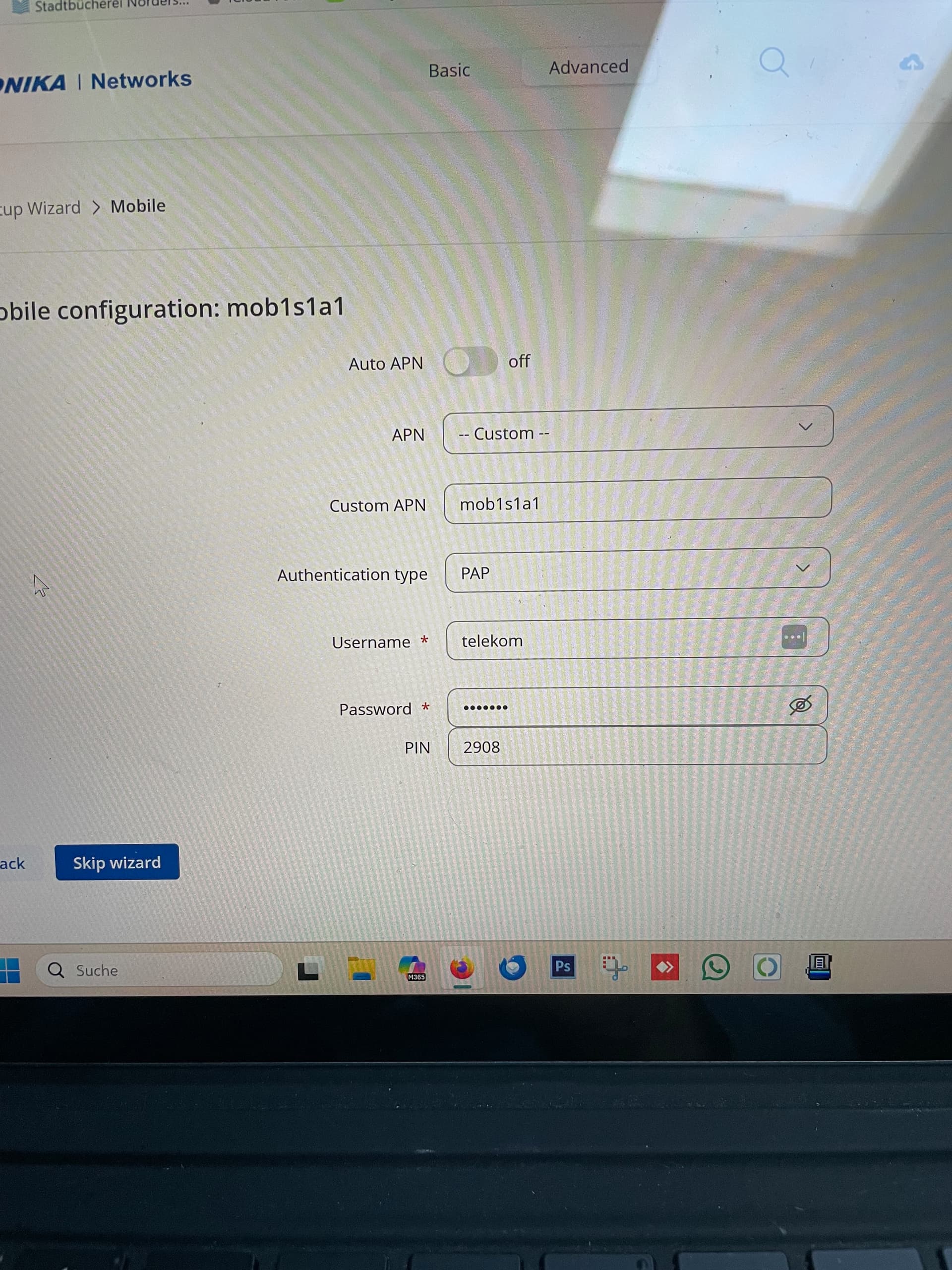

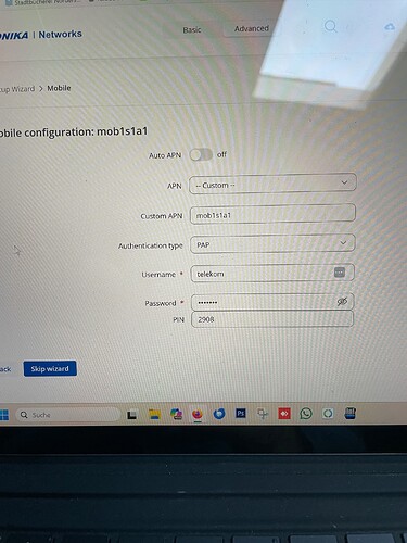

But what is the correct APN? I tried not with custom, same: no connection.
It works last year, that is, what i do not understand. I often have problems with your router.
I bought it in a bundle with the Roam antenna. But not happy with the router. A friend had same problems with your router. Would like to use your RUTX50, but it is soo expensive and i bought mine a year ago. Is it possible to chance?
The correct APN for your connection is internet.telekom. Please ensure that this APN is set correctly in both:
  • Network → Mobile → General
  • Network → WAN → mob1s1a1
Additionally, please verify that the credentials (username, password) for PAP authentication type are specified correctly.
