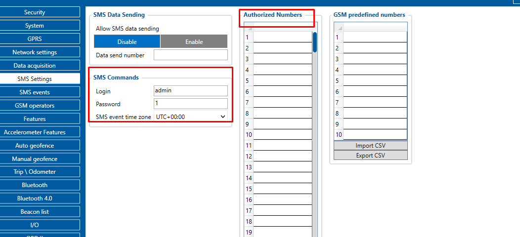

  1. If the login and password are incorrect the FMC130 will not response to your SMS commands.
    Or your number is not on the authorized list
  2. If the FMC130 sim doesn’t have SMS subscription.
  3. FMC130 is offline.
Kindly check the following list above.
