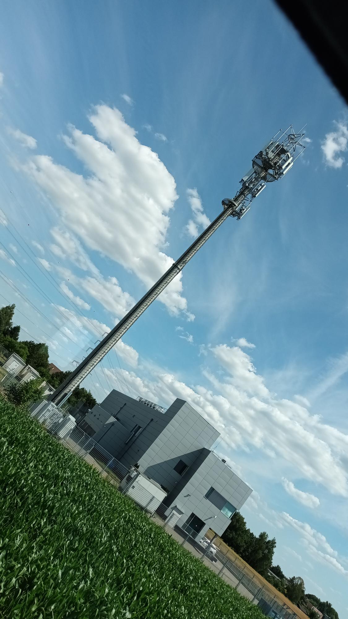

Attached is a picture of the telecommunication mast, located approximately 150-200 meters from the router.
This is almost unusable, if at all. Having very high or high values for RSSI and RSRP don’t mean much if the signal quality is bad.
Looking at the picture, it seems you are in rural or semi-rural area so the mobile operator may have set the inclination of the antennas to cover the largest possible distance. So beeing very close to the cell tower means that you probably miss it and what you receive is a combination of an attenuated signal from another tower and a lot of interferences from reflexions from this one.

Could you try checking the router further away from the cell tower in the direction that the sector antennas are oriented?
No, probably. All the installed antennas are omnidirectional so they will grab all unwanted reflexions from all directions this explains the unbelievably high RSSI value and crappy SINR.
One workaround would be to determine the location of the cell tower the router connects to (your mobile provider should be able to help you here, or try with LTEdiscovery on Android it has an arrow) and use a very directional antenna with a high gain. This one gave me entire satisfaction. You will need two sets for the RUTX50.
There is another possibility I may have missed, the router indeed connects to the tower 200m away and receives a signal so strong it is distorded before sampling.
