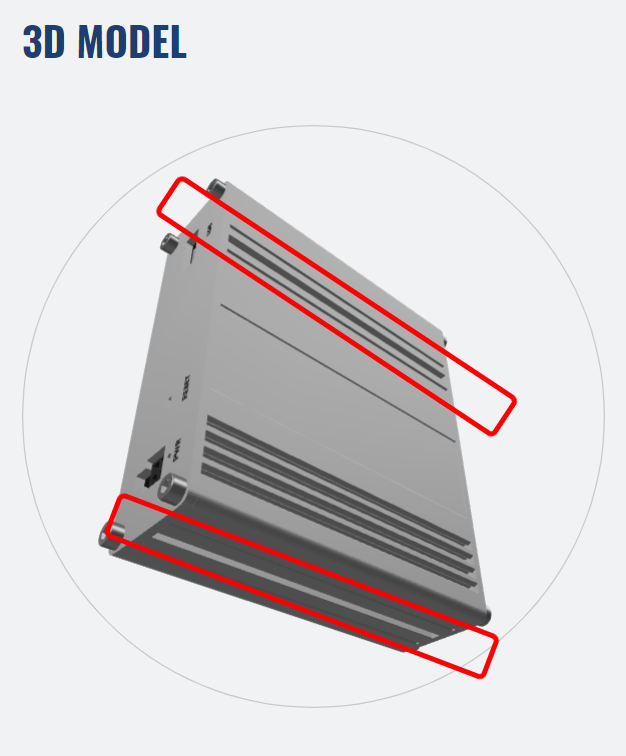

The answer really depends on a few factors, however, in general - yes, you will be able to power the RUT300 even if it’s mounted on a DIN rail.
RUT300 includes mounting grooves for DIN rail holders on the side and back panels, thus if there is nothing else that is covering the device, accessing the 4-pin connector will not be an issue.
Additionally, RUT300 can also be powered using passive PoE via the LAN1 port. More information can be found here: RUT300 Powering Options - Teltonika Networks Wiki
