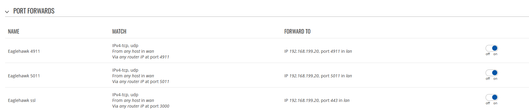

If i tried to enable https access on RUT241 (RUT2M_R_00.07.04.4 ) WEBUI (System/Administration/Access Control) and login to that i only get to Login Screen, after sending User/Password device is unreachable (see pictures).
The same problem exists with every portforwarding. I wasn’t able to connect to the specified ports.

Hi, I’ll assume that you don’t have any custom firewall rules configured, besides enabling HTTPS access, and will guess that this is likely some sort of MTU issue. Could you try to set MTU on your mobile interface to values such as:
  • 1420
  • 1460
  • 1500
and see if making any of these changes will let you to login to your device? I’d also try opening a private (incognito) window just to ensure that browser caching is not interfering here in any way whatsoever.
You should be able to change your mobile interface MTU value in advanced settings. You can also check out the wiki to figure out precisely where MTU value override setting is located at: [RUT241 Interfaces - Teltonika Networks Wiki]
P.S. just in case my assumption is wrong and you do have some additional custom firewall rules - can you please share it all here?

I tried an other browser, and cleaned cache already. My solution was to use the old 00.07.04.4 firmware. There remote ssl port for WebUI is available and all other portforwardings i configure.
The portforwarding is the same like i use all the time with older firmwares.
I think the new firmware RUT2M_R_00.07.04.4_WEBUI is buggy in case of portforwarding. Wireguard VPN works as usual but no portforwarding to custom ports. Wireguard port is opened by system but all other ports custom ports are closed.
With old firmware (RUT2M_R_00.07.02.7_WEBUI) everything works …
