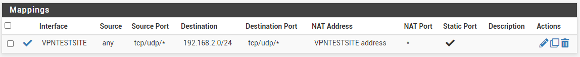

Test 1 : Masquerade (NAT) packets on PfSense that are coming from the Internet client with the IP address of the tunnel interface (10.2.2.1).
Work fine with add in Firewall / Nat / Outbound on Pfsense, need to create a physical interface for OpenVPN
