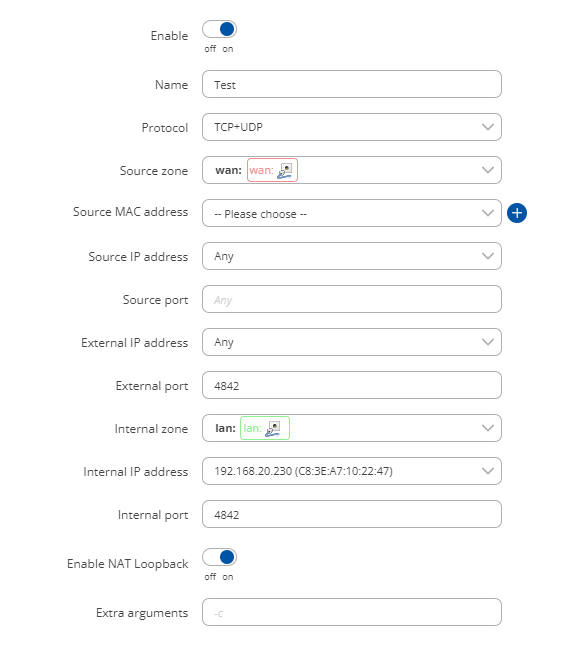

I’m trying to achieve a simple port forwarding to an internal LAN network. I can connect on WAN port to router, (on port 22 also). I can connect to desired service when I’m in internal network. But when I try to use port forward on it will not allow me to access website. What am I missing?
WAN IP: 10.65.33.2/24
LAN service IP: 192.168.20.230/24
port: 4842

I’m using this router as to separate an internal network from my on network so WAN IP is correct. WAN is using wired connection, not SIM.
I’m connected to 10.65.33.0/24 (my ip: 10.65.33.220) network so I’m on the WAN side of the network and I’m trying to get access to internal server behind router. I’m not trying to gain access from the internet. Just from the WAN side of the network for this case.
In this case, the rule looks fine and you should be access your LAN device by connecting to 10.65.33.2 on port 4842.
