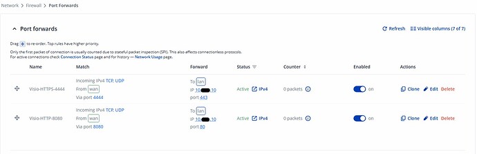

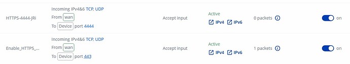

For Traffic Rules, I have this. Hmm… Wan to Device. Should it be WAN to LAN and destination address is the Server’s LAN IP? I think I tested that as well and it didn’t work.
From rule counters it seems like no packets with specified match have arrived. So either router is unreachable via public IP or something is wrong with port forward rule

  1. Did you just created port forward rule or changed something in edit?
  2. Besides one port forward and one traffic rule did you changed/added anything else in firewall pages?
Also about traffic rule: just remove it as port forward already handles allowing traffic from wan zone.

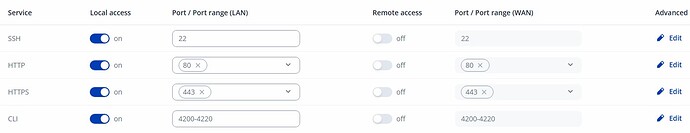

  2. See access control on Pic. https://publicIP doesn’t work. Https://Servers-LAN-IP opens correct page in LAN enviroment.

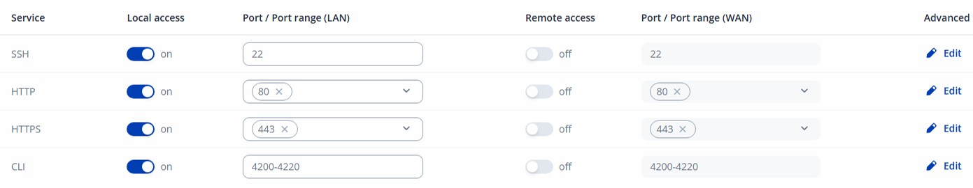

Enable this colon for http/https when checking if you can reach WebUI via public IP
If WebUI via public IP works with both default and non-default ports then I recommend resetting device and just creating two simple port forward rules without any other firewall changes.

For starters, the RUTx50 is already in rpoducton having Site-t-Site VPN to 5 diffrenet Remote LANs. Can’t really reset the box. Maybe there is an eventviewer or log to check what goes wrong. Enabling Remote Access to HTTP (80) and HTTPS (443) didn’t help.

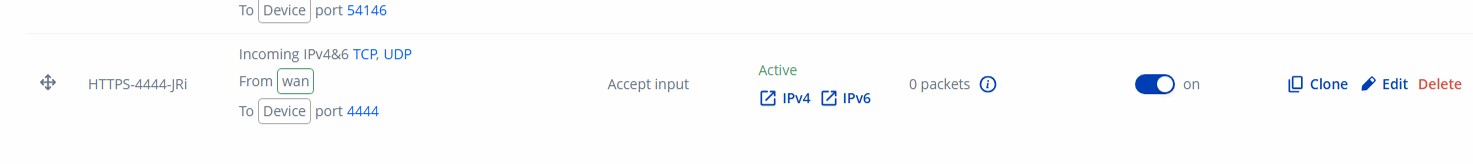

At Traffic Rules. Should I allow 4444 from WAN to LAN to the Server’s LAN IP?
Enabling Remote Access was just to test if you can reach your device via specific ports using simpler configuration. It was not intended to help your port forward. For your port forward you don’t need ANY traffic rules nor any should be created automatically (although it should not cause any problems).
