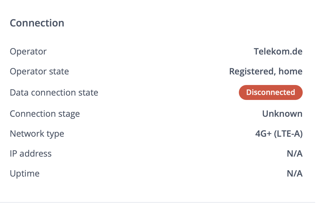

After the switch the Connection will not be setup again and no IP is assigned. A /etc/init.d/network restart does also not help.
On the first switch the Staus on Status→Network→Mobile changes the ICCID but if I attempt to with a second time, it will not update anymore.
Is there probably a setting I can tell the router to handle the sim as you do with your sim capable routers?
Hi!
if I read the logs correctly, it even gets a IP but then fails. The Log shows the moment starting from the esim change. The old IP on the modem with the other eSIM profile before switch ended with 159.

796 Tue Nov 11 10:37:56 2025 daemon.notice netifd: mob1s2a1 (15139): “dns2”: “2a01:598:7ff:0:10:74:210:211”
797 Tue Nov 11 10:37:56 2025 daemon.notice netifd: mob1s2a1 (15139): },
798 Tue Nov 11 10:37:56 2025 daemon.notice netifd: mob1s2a1 (15139): “domain-names”: {
799 Tue Nov 11 10:37:56 2025 daemon.notice netifd: mob1s2a1 (15139):
800 Tue Nov 11 10:37:56 2025 daemon.notice netifd: mob1s2a1 (15139): }
801 Tue Nov 11 10:37:56 2025 daemon.notice netifd: mob1s2a1 (15139): }
802 Tue Nov 11 10:37:56 2025 daemon.notice netifd: Interface ‘mob1s2a1_6’ is enabled
803 Tue Nov 11 10:37:56 2025 daemon.notice netifd: Interface ‘mob1s2a1_6’ is setting up now
804 Tue Nov 11 10:37:56 2025 daemon.notice netifd: Interface ‘mob1s2a1_6’ is now up
805 Tue Nov 11 10:37:56 2025 daemon.notice netifd: Interface ‘mob1s2a1_6’ has link connectivity
806 Tue Nov 11 10:37:56 2025 daemon.info dnsmasq[3856]: reading /tmp/resolv.conf.d/resolv.conf.auto
807 Tue Nov 11 10:37:56 2025 daemon.info dnsmasq[3856]: using nameserver 2a01:598:7ff:0:10:74:210:210#53
808 Tue Nov 11 10:37:56 2025 daemon.info dnsmasq[3856]: using nameserver 2a01:598:7ff:0:10:74:210:211#53
809 Tue Nov 11 10:37:56 2025 daemon.info dnsmasq[3856]: using only locally-known addresses for test
810 Tue Nov 11 10:37:56 2025 daemon.info dnsmasq[3856]: using only locally-known addresses for onion
811 Tue Nov 11 10:37:56 2025 daemon.info dnsmasq[3856]: using only locally-known addresses for localhost
812 Tue Nov 11 10:37:56 2025 daemon.info dnsmasq[3856]: using only locally-known addresses for local
813 Tue Nov 11 10:37:56 2025 daemon.info dnsmasq[3856]: using only locally-known addresses for invalid
814 Tue Nov 11 10:37:56 2025 daemon.info dnsmasq[3856]: using only locally-known addresses for bind
815 Tue Nov 11 10:37:56 2025 daemon.info dnsmasq[3856]: using only locally-known addresses for lan
816 Tue Nov 11 10:37:56 2025 daemon.notice netifd: mob1s2a1_4 (15724): udhcpc: started, v1.34.1
817 Tue Nov 11 10:37:56 2025 daemon.notice netifd: mob1s2a1_4 (15724): udhcpc: broadcasting discover
818 Tue Nov 11 10:37:56 2025 daemon.notice netifd: mob1s2a1_4 (15724): udhcpc: broadcasting select for 10.42.194.119, server 10.42.194.120
819 Tue Nov 11 10:37:56 2025 daemon.notice netifd: mob1s2a1_4 (15724): udhcpc: lease of 10.42.194.119 obtained from 10.42.194.120, lease time 7200
820 Tue Nov 11 10:37:56 2025 daemon.notice netifd: Interface ‘mob1s2a1_4’ is now up
821 Tue Nov 11 10:37:56 2025 daemon.info dnsmasq[3856]: reading /tmp/resolv.conf.d/resolv.conf.auto
822 Tue Nov 11 10:37:56 2025 daemon.info dnsmasq[3856]: using nameserver 10.74.210.210#53
823 Tue Nov 11 10:37:56 2025 daemon.info dnsmasq[3856]: using nameserver 10.74.210.211#53
824 Tue Nov 11 10:37:56 2025 daemon.info dnsmasq[3856]: using nameserver 2a01:598:7ff:0:10:74:210:210#53
825 Tue Nov 11 10:37:56 2025 daemon.info dnsmasq[3856]: using nameserver 2a01:598:7ff:0:10:74:210:211#53
826 Tue Nov 11 10:37:56 2025 daemon.info dnsmasq[3856]: using only locally-known addresses for test
827 Tue Nov 11 10:37:56 2025 daemon.info dnsmasq[3856]: using only locally-known addresses for onion
828 Tue Nov 11 10:37:56 2025 daemon.info dnsmasq[3856]: using only locally-known addresses for localhost
829 Tue Nov 11 10:37:56 2025 daemon.info dnsmasq[3856]: using only locally-known addresses for local
830 Tue Nov 11 10:37:56 2025 daemon.info dnsmasq[3856]: using only locally-known addresses for invalid
831 Tue Nov 11 10:37:56 2025 daemon.info dnsmasq[3856]: using only locally-known addresses for bind
832 Tue Nov 11 10:37:56 2025 daemon.info dnsmasq[3856]: using only locally-known addresses for lan
833 Tue Nov 11 10:37:57 2025 user.notice mwan3-hotplug[15636]: Execute ifup event on interface mob1s2a1 (wwan0)
834 Tue Nov 11 10:37:57 2025 daemon.info mobifd: [gsm.modem0] Modem settings init completed
835 Tue Nov 11 10:37:57 2025 daemon.info mobifd: [gsm.modem0] Starting connection setup
836 Tue Nov 11 10:37:57 2025 daemon.info mobifd: [gsm.modem0] Attempting to establish connection to operator with “15s” of timeout
837 Tue Nov 11 10:37:57 2025 daemon.info mobifd: [gsm.modem0] Connected to operator “26201”
838 Tue Nov 11 10:37:58 2025 daemon.notice netifd: mob1s2a1 (16074): Stopping network mob1s2a1
839 Tue Nov 11 10:37:58 2025 kern.info Switched to main WAN (mob1s2a1)
840 Tue Nov 11 10:37:58 2025 user.notice qmux: Stopping network on device: /dev/cdc-wdm0 cid: 21
841 Tue Nov 11 10:37:58 2025 user.notice netifd: uqmi -s -d /dev/cdc-wdm0 -t 3000 --set-client-id wds,21 --stop-network 0xFFFFFFFF --autoconnect
842 Tue Nov 11 10:37:58 2025 daemon.notice netifd: Interface ‘mob1s2a1_6’ is now down
843 Tue Nov 11 10:37:58 2025 daemon.notice netifd: Interface ‘mob1s2a1_6’ has link connectivity loss
844 Tue Nov 11 10:37:58 2025 daemon.warn dnsmasq[3856]: no servers found in /tmp/resolv.conf.d/resolv.conf.auto, will retry
845 Tue Nov 11 10:37:58 2025 daemon.notice netifd: Network device ‘qmimux0’ link is down
846 Tue Nov 11 10:37:58 2025 daemon.notice netifd: Interface ‘mob1s2a1_4’ has link connectivity loss
847 Tue Nov 11 10:37:58 2025 user.info mwan3track[5372]: Detect ifup event on interface mob1s2a1 (qmimux0)
848 Tue Nov 11 10:37:58 2025 user.notice qmux: Freeing cid: 21
849 Tue Nov 11 10:37:58 2025 user.notice netifd: uqmi -s -d /dev/cdc-wdm0 -t 3000 --set-client-id wds,21 --release-client-id wds
850 Tue Nov 11 10:37:58 2025 daemon.info mobifd: [gsm.modem0] -CFUN- Functionality: “Full”
851 Tue Nov 11 10:37:58 2025 daemon.info mobifd: [gsm.modem0] -COPS- Mode: “Auto”, operator: “26201”
852 Tue Nov 11 10:37:58 2025 daemon.info mobifd: [gsm.modem0] -CREG- Mode: “Enabled (with location information)”, status: “Registered, home”, LAC: “1495”, cell ID: “26368774”, technology: “E-UTRAN”
853 Tue Nov 11 10:37:58 2025 daemon.info mobifd: [gsm.modem0] -CGREG- Mode: “Enabled (with location information)”, status: “Registered, home”, LAC: “1495”, cell ID: “26368774”, technology: “E-UTRAN”
854 Tue Nov 11 10:37:58 2025 daemon.info mobifd: [gsm.modem0] -CEREG- Mode: “Enabled (with location information)”, status: “Registered, home”, LAC: “”, cell ID: “26368774”, technology: “E-UTRAN”
855 Tue Nov 11 10:37:59 2025 daemon.notice netifd: Interface ‘mob1s2a1_4’ is disabled
856 Tue Nov 11 10:37:59 2025 daemon.notice netifd: mob1s2a1_4 (15724): udhcpc: SIOCGIFINDEX: No such device
857 Tue Nov 11 10:37:59 2025 daemon.notice netifd: mob1s2a1_4 (15724): udhcpc: received SIGTERM
858 Tue Nov 11 10:37:59 2025 daemon.notice netifd: mob1s2a1_4 (15724): udhcpc: unicasting a release of 10.42.194.119 to 10.42.194.120
859 Tue Nov 11 10:37:59 2025 daemon.notice netifd: mob1s2a1_4 (15724): udhcpc: sending release
860 Tue Nov 11 10:37:59 2025 daemon.notice netifd: mob1s2a1_4 (15724): udhcpc: can’t bind to interface qmimux0: No such device
861 Tue Nov 11 10:37:59 2025 daemon.notice netifd: mob1s2a1_4 (15724): udhcpc: bindtodevice: No such device
862 Tue Nov 11 10:37:59 2025 daemon.notice netifd: mob1s2a1_4 (15724): udhcpc: entering released state
863 Tue Nov 11 10:37:59 2025 daemon.notice netifd: mob1s2a1 (16074): Command failed: Permission denied
864 Tue Nov 11 10:37:59 2025 user.notice qmux: Stopping network on device: /dev/cdc-wdm0 cid: 22
865 Tue Nov 11 10:37:59 2025 user.notice netifd: uqmi -s -d /dev/cdc-wdm0 -t 3000 --set-client-id wds,22 --stop-network 0xFFFFFFFF --autoconnect
866 Tue Nov 11 10:37:59 2025 daemon.notice netifd: Interface ‘mob1s2a1’ is now down
867 Tue Nov 11 10:37:59 2025 daemon.notice netifd: mob1s2a1_4 (15724): Command failed: Permission denied
868 Tue Nov 11 10:37:59 2025 daemon.notice netifd: Interface ‘mob1s2a1_4’ is now down
869 Tue Nov 11 10:37:59 2025 daemon.info mobifd: [gsm.modem0] IP address on PDP context “1”: “10.42.194.119”
870 Tue Nov 11 10:37:59 2025 user.notice qmux: Freeing cid: 22
871 Tue Nov 11 10:37:59 2025 user.notice netifd: uqmi -s -d /dev/cdc-wdm0 -t 3000 --set-client-id wds,22 --release-client-id wds
872 Tue Nov 11 10:37:59 2025 daemon.notice netifd: Interface ‘mob1s2a1’ is setting up now
873 Tue Nov 11 10:37:59 2025 daemon.notice netifd: mob1s2a1 (16365): wwan[16365] Using wwan usb device on bus 3-1
874 Tue Nov 11 10:37:59 2025 daemon.notice netifd: mob1s2a1 (16365): wwan[16365] Using proto:qmux device:/dev/cdc-wdm0 iface:wwan0 desc:Quectel EG06
875 Tue Nov 11 10:38:00 2025 user.notice firewall: Reloading firewall due to ifup of mob1s2a1 (wwan0)
876 Tue Nov 11 10:38:01 2025 user.notice qmux: mob1s2a1 teardown successful
877 Tue Nov 11 10:38:02 2025 daemon.info dnsmasq[3856]: read /etc/hosts - 12 names
878 Tue Nov 11 10:38:02 2025 daemon.info dnsmasq[3856]: read /tmp/hosts/dhcp.cfg01411c - 4 names
879 Tue Nov 11 10:38:02 2025 daemon.info dnsmasq-dhcp[3856]: read /etc/ethers - 0 addresses
880 Tue Nov 11 10:38:02 2025 user.notice nlbwmon: Reloading nlbwmon due to ifup of mob1s2a1 (wwan0)
881 Tue Nov 11 10:38:03 2025 kern.info Joined LTE network (internal modem)
882 Tue Nov 11 10:38:03 2025 kern.info Connected to 26201 operator (internal modem)
883 Tue Nov 11 10:38:03 2025 user.notice mwan3-hotplug[17207]: Execute ifdown event on interface mob1s2a1 (unknown)
884 Tue Nov 11 10:38:03 2025 user.info mwan3track[5372]: Detect ifdown event on interface mob1s2a1 ()
885 Tue Nov 11 10:38:04 2025 user.notice mwan3track[5372]: Interface mob1s2a1 () is offline
886 Tue Nov 11 10:38:04 2025 user.notice mwan3-hotplug[17300]: Execute disconnected event on interface mob1s2a1 (unknown)
887 Tue Nov 11 10:38:05 2025 kern.info WAN (mob1s2a1) is down, no more backups to switch
888 Tue Nov 11 10:38:06 2025 daemon.info dnsmasq[3856]: read /etc/hosts - 12 names
889 Tue Nov 11 10:38:06 2025 daemon.info dnsmasq[3856]: read /tmp/hosts/dhcp.cfg01411c - 4 names
890 Tue Nov 11 10:38:06 2025 daemon.info dnsmasq-dhcp[3856]: read /etc/ethers - 0 addresses
891 Tue Nov 11 10:38:07 2025 kern.info Mobile data disconnected (internal modem)
892 Tue Nov 11 10:38:07 2025 daemon.info dnsmasq[3856]: read /etc/hosts - 12 names
893 Tue Nov 11 10:38:07 2025 daemon.info dnsmasq[3856]: read /tmp/hosts/dhcp.cfg01411c - 4 names
894 Tue Nov 11 10:38:07 2025 daemon.info dnsmasq-dhcp[3856]: read /etc/ethers - 0 addresses
895 Tue Nov 11 10:38:32 2025 daemon.notice netifd: mob1s2a1 (16365): Command failed: Request timed out
896 Tue Nov 11 10:38:32 2025 daemon.notice netifd: mob1s2a1 (16365): This interface uses different esim profile: 0.
897 Tue Nov 11 10:38:32 2025 daemon.notice netifd: mob1s2a1 (16365): 3-1 mob1s2a1 reloading mobifd
