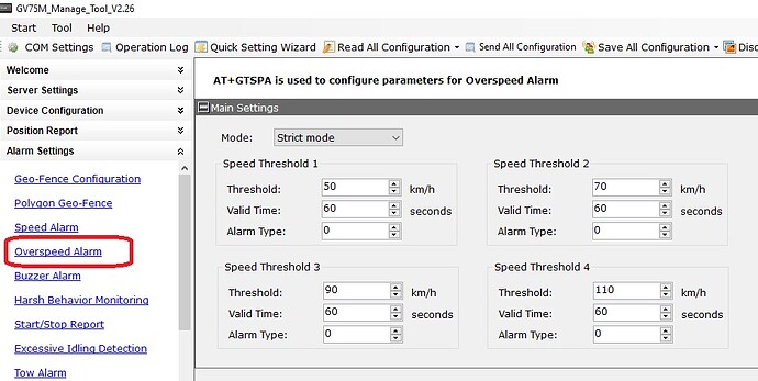

Overspeeding whit multiples speeds and alarmas
anyone know if the FMC130 or FMC150 devices have a funtion like this one?
Is for set multiples speed limits and buzzer alarmas.
Teltonika support this funtion in 130 and 150 or in others models?

Thanks, but this is not what we need, we need different limits for the speed, not for the speed in a zone in particular. Thanks.
