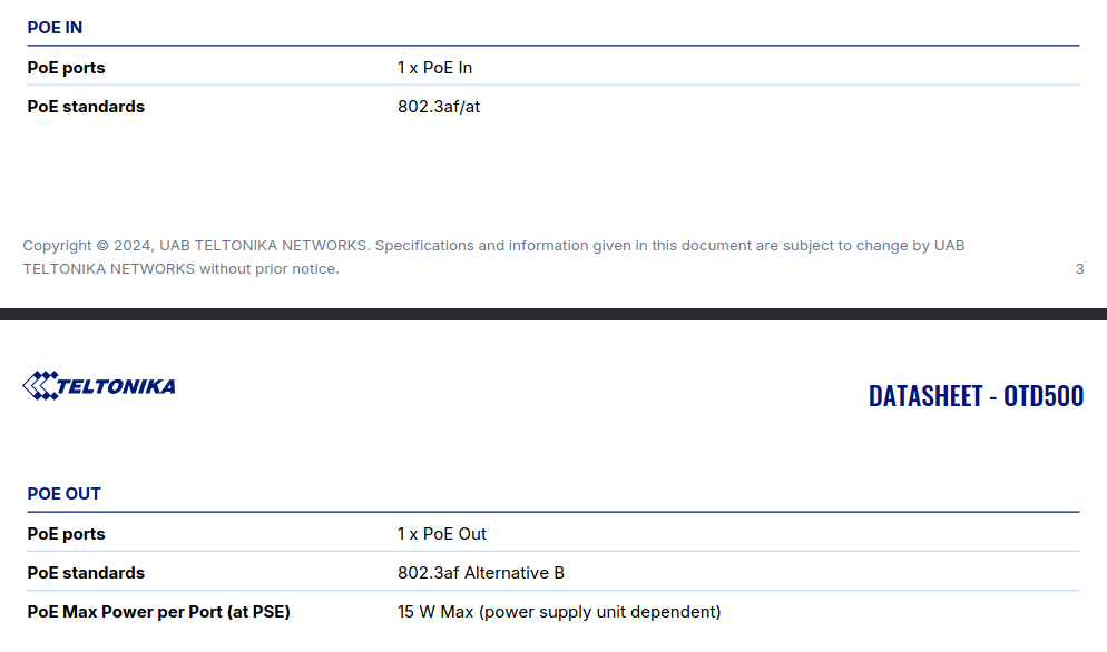

Datasheet of the OTD500 says only Alternative B for the Output, so Input could be Alternative A as well?

Then you might want to correct the datasheet, because it shows only variant B for the PoE Output, not for the input. Thats why i did guess the input could accept variant A or B.
According to the specifications of this third-party PoE adapter, I believe it should work. However, please note that this particular injector has not been officially tested with TRB500.
