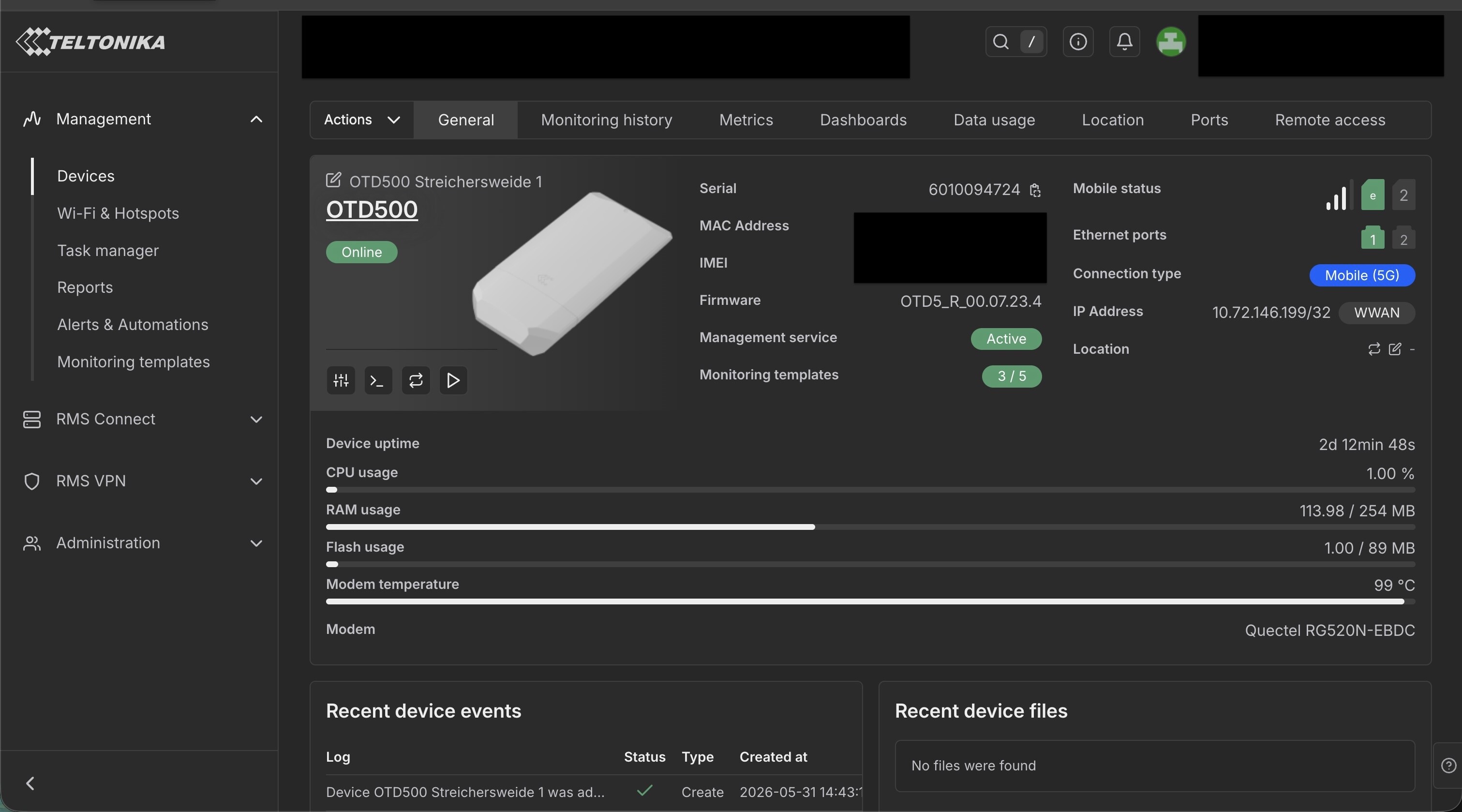

Bildschirmfoto 2026-06-01 um 08.56.00
Under load, the modem heats up to 98°C. Parts of the frequency bands—in my case, 5GN1—are disconnected. Occasionally, the modem completely loses its network connection and restarts. It is currently installed indoors at a room temperature of 22°C. Without any load—i.e., no downloading or streaming—the temperature hovers around 82–85°C.
As it stands, the modem is useless. It remains unclear whether it suffers from a technical defect.

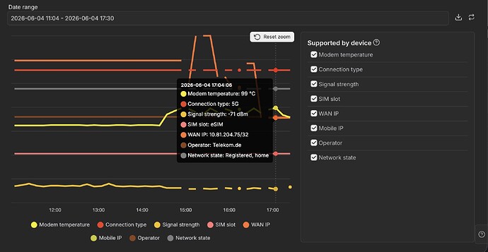

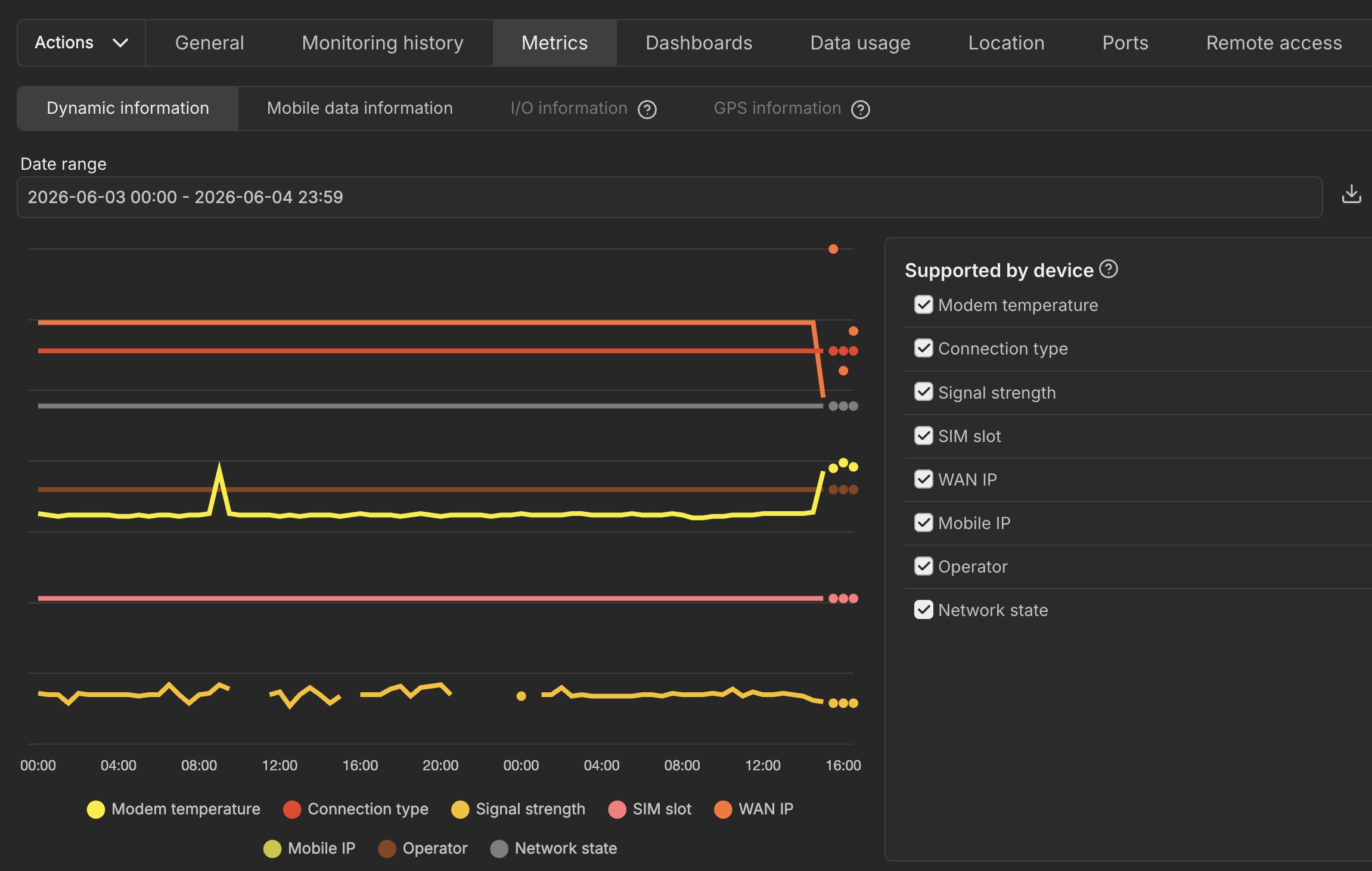

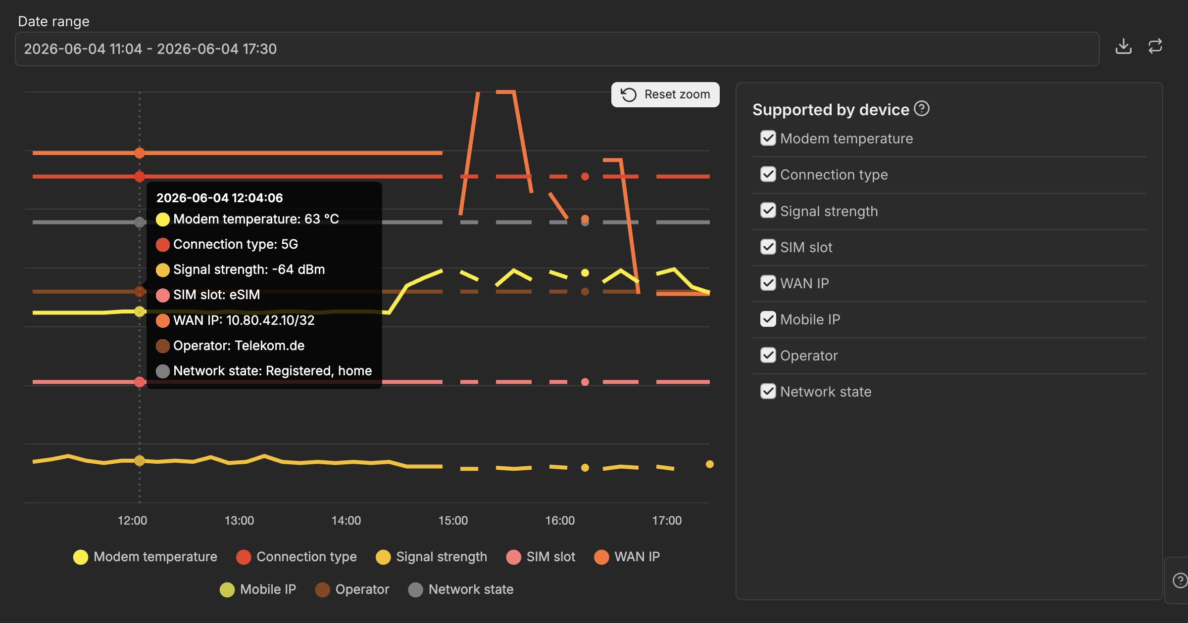

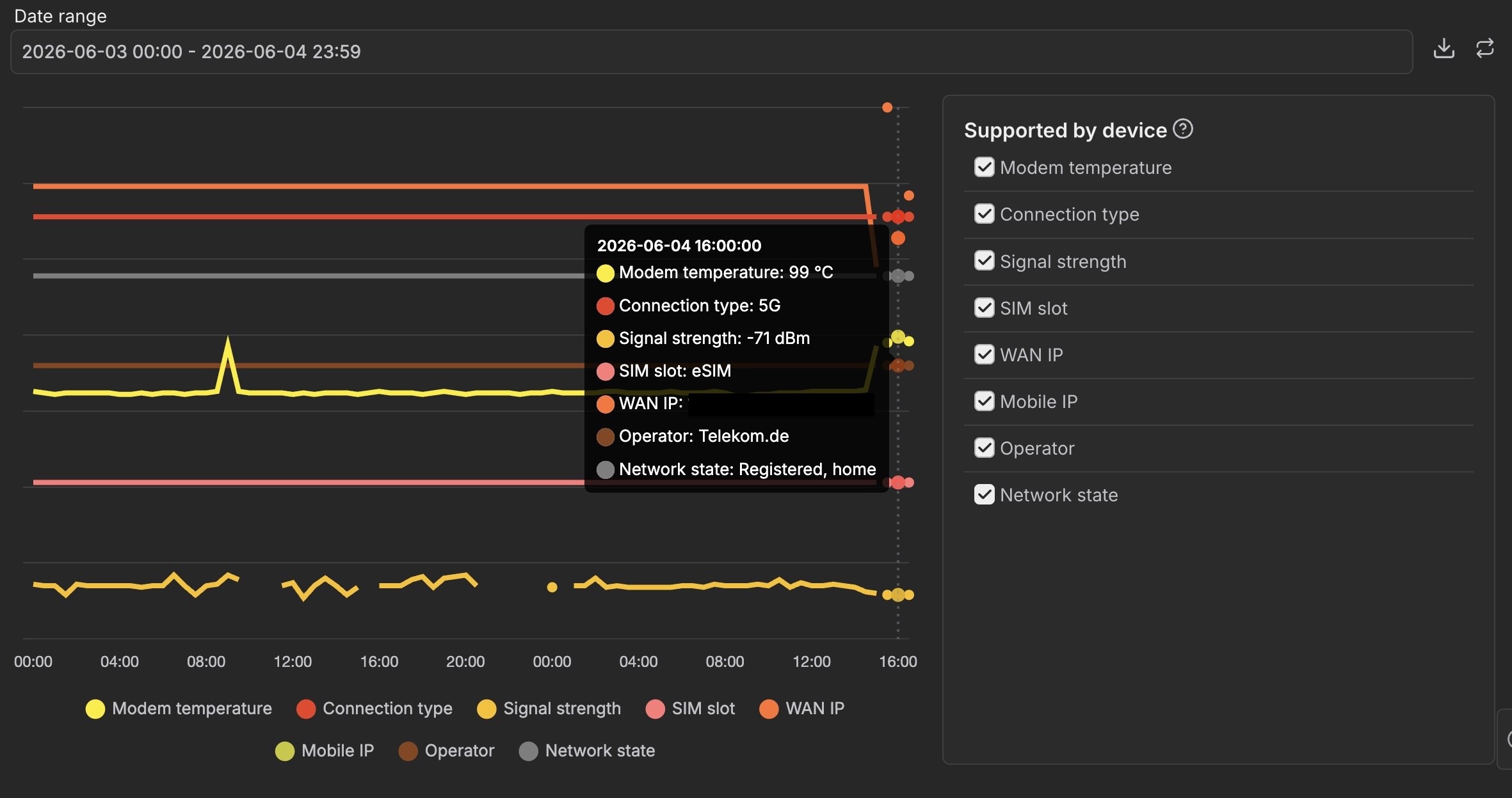

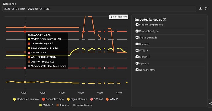

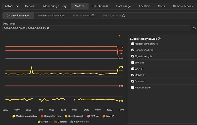

Today i did some more tests.
The OTD ist installed indoor in my office. The temperature there is 22 °C. In case of very low throughput at the up- and downlink the modem is about 62-65 °C. In my opinion at an ambient temperature of 22°C to hight. The modem is designed for ambient temperatures of 55 degrees.
I did start a upload of a 8 GB file to my MS One-Drive. In less minutes the temperature of the modem goes up to 99 degrees. It´s look like the Modem has a problem withe CPU load during at high traffic. The connection to the Network Deutsche Telekom via NAS 5G. I use only a e-SIM. The Modem works in NAT mode.
As you can see in the last screenshots the modem disconnects from the Network an reconnects until the temperature grows up again.

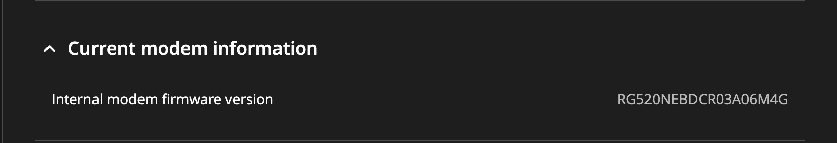

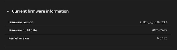

Can you maybe post your FW and Modem FW informations ?
What HW Version and Batch is your unit ?

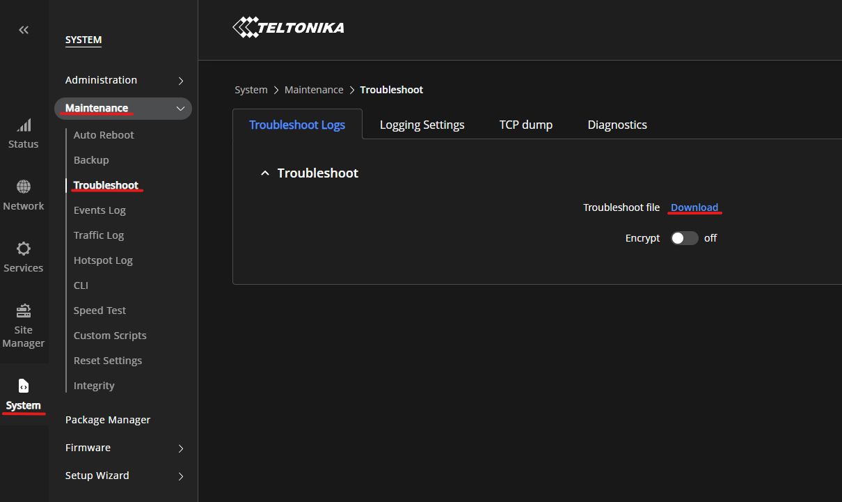

Can you provide me some detailed information to get the tracefiles ?
Hello, @Ahrensfd,
The troubleshoot files can be downloaded from the devices WebUI by navigating to System → Maintenance → Troubleshoot, there you’ll find a Download button.
Please keep in mind that this is a public forum, and we strongly recommend not uploading any sensitive information or data here.
