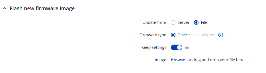

Could you please try updating the firmware manually to the latest version, OTD5_R_00.07.20.1_WEBUI.bin? You can download it from the following link: https://wiki.teltonika-networks.com/view/OTD500_Firmware_Downloads
To update the firmware from a file, navigate to System → Firmware → Update Firmware, then select Update from File, as shown in the image below.
Please let me know the results.
