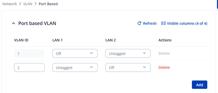

I’m trying to use OTD140 as Failover with WAN (I’m using this config with RUT241).
As OTD140 claims to have Failover WAN backup (https://www.youtube.com/watch?v=MGBe_RwNO8k&t=76). Failover package I have installed.
But I could not find any easy way how to set it up. I have to use CLI to set VLANs, switch, ports, …
I’m missing in Network → LAN setting Use WAN port as LAN / LAN to WAN.
Is there easy way how to setup WAN port from bridged LAN?
Check this out.
Thanks, that’s it.
Correct settings of VLAN is on the picture bellow.
