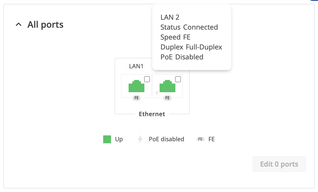

  1. I can see the status of ports on the GUI but it claims port 2 has PoE disabled even though the camera connected to it works.

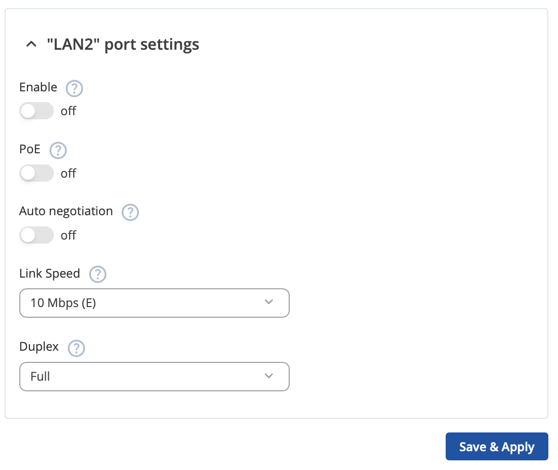

  1. When I select either port for editing I get a config screen for an unconnected port even though both ports are connected and live.

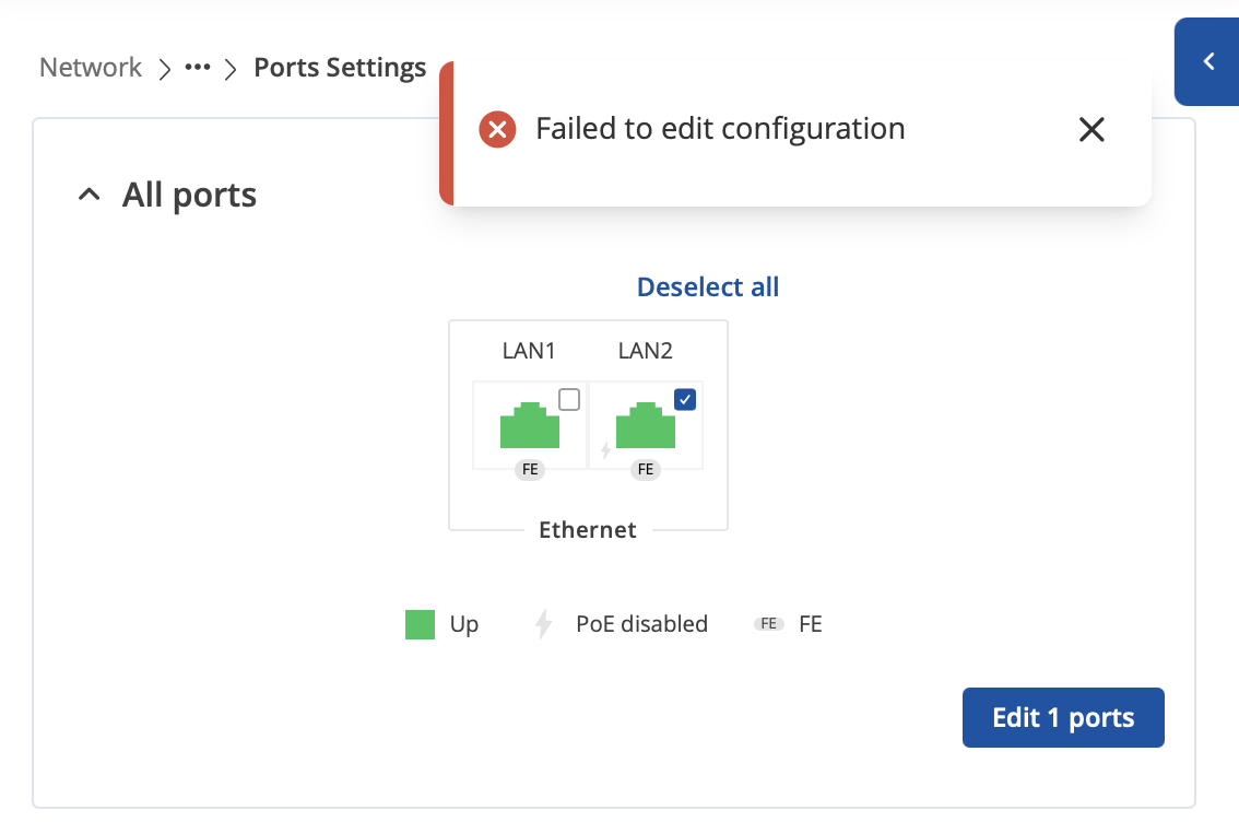

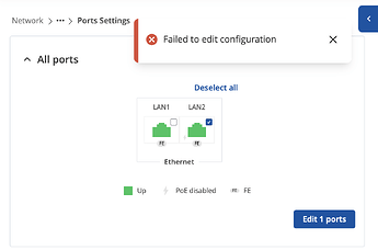

  1. When I edit a port config and hit save, I get “Failed to edit configuration” notification and nothing has changed.

The issue is related to updating the device with “Keep settings.” Our developers are currently resolving it, and a fix will be included in a future firmware updates.
For now, the recommended workaround is to perform a factory reset on the device.
We appreciate your understanding and patience.
A fix for this issue is planned to be included in the 7.18 firmware release.
