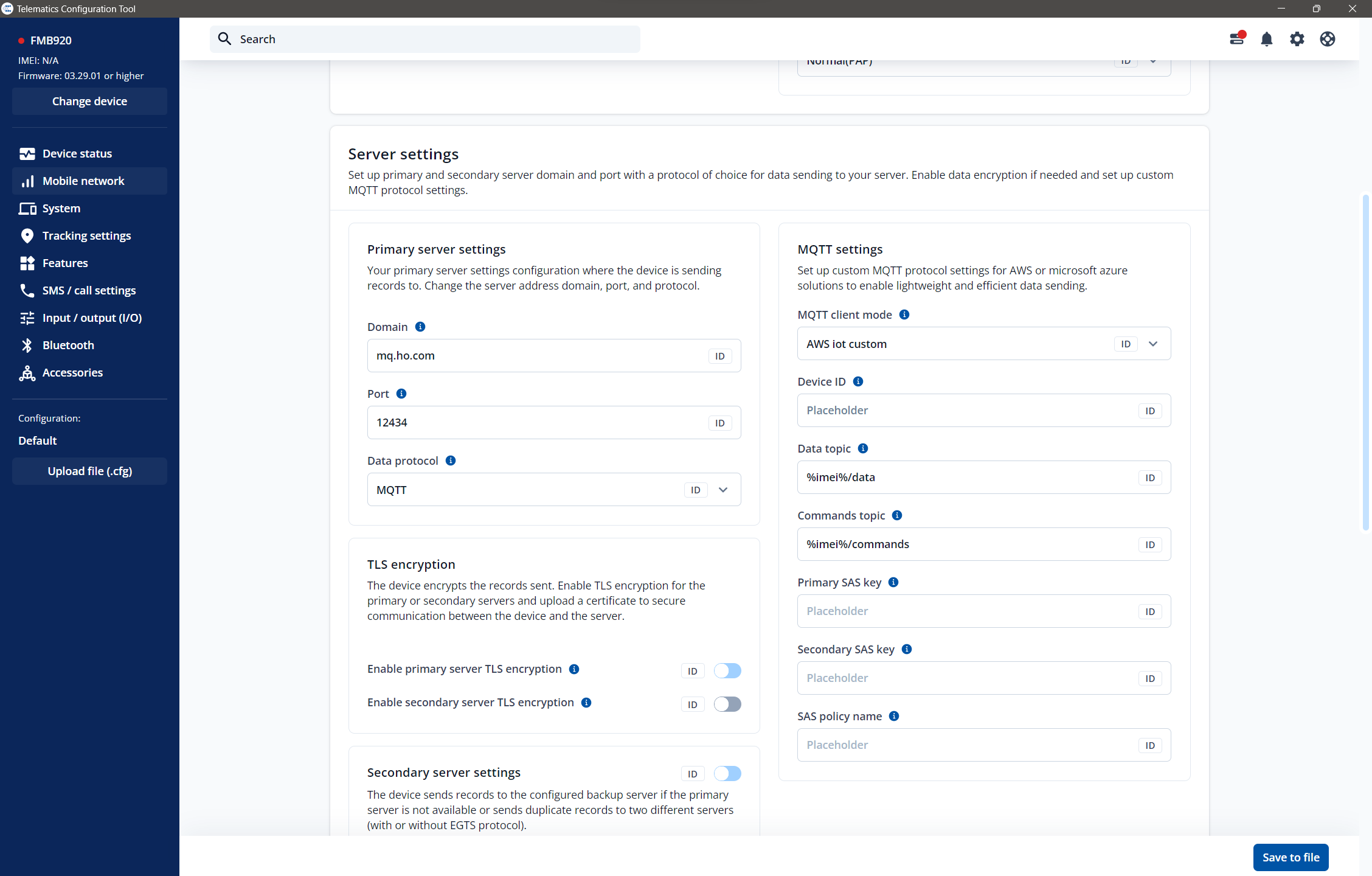

When configuring a profile in Offline mode, I see more options. Specifically, I am looking to get my FMB920 communicating via MQTT, but am not having much luck.
To my surprise, opening the FMB920 offline, shows a few more settings, specifically related to MQTT… in the upper left, it show 03.29.01 “firmware”. Is this just a place holder/generic firmware that shows options not necessarily compatible with all trackers?
Or is there a version of firmware newer than the version I’m running? (03.27.14)
MQTT functionality ( 03.27.10.Rev.520) is ported to base 28 firmware to have the test firmware kindly contact your sales manager or create a ticket via Helpdesk.
Wiki page: FMB140 Getting Started with AWS IoT Core - Wiki Knowledge Base | Teltonika GPS (teltonika-gps.com)
If you don’t have any contact with our Sales managers, please contact them on our official website https://teltonika-gps.com/ and click on the “Contact Us” button. When you click, please fill out the form and submit it. Note: as a topic, please choose “Vehicle telematics”. Or you can send an e-mail with a description of your situation to info@teltonika.lt
