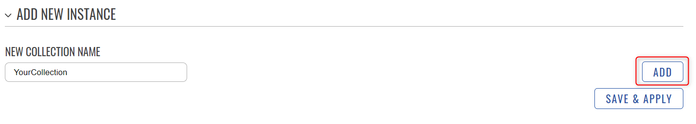

In the Data to Server, create a collection:

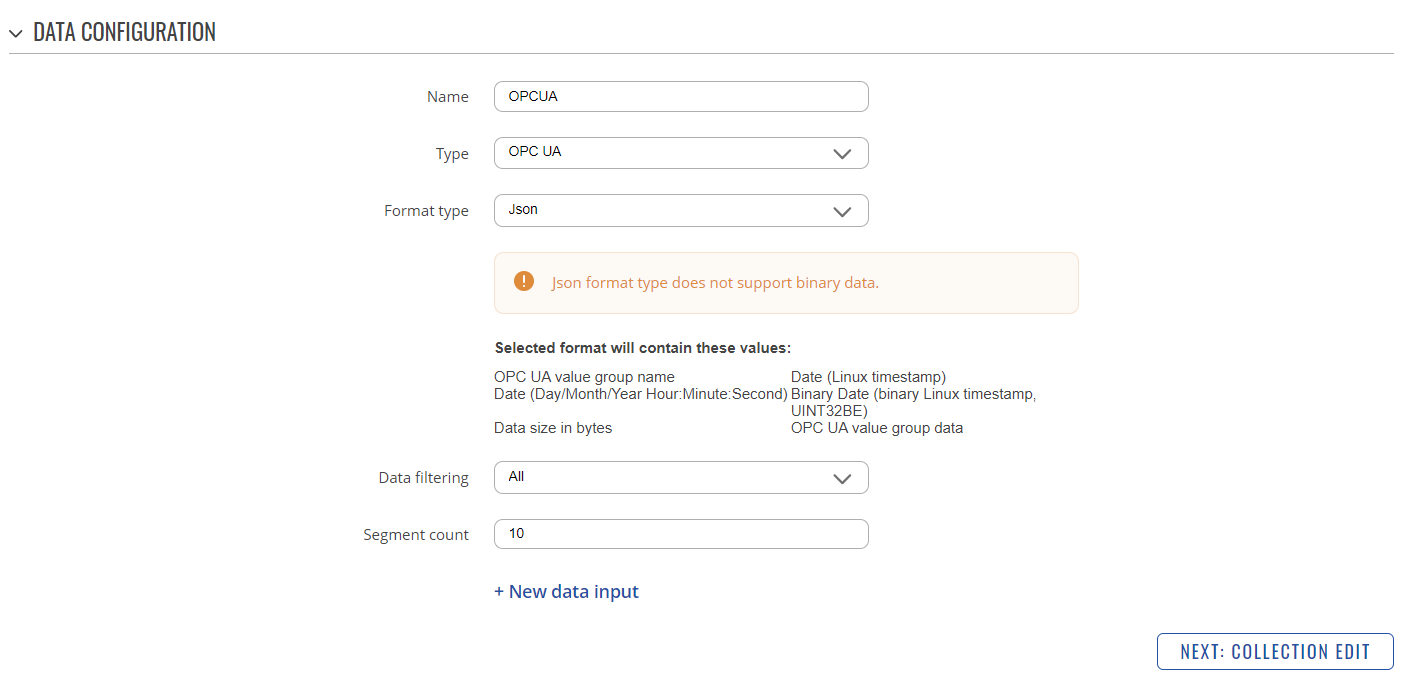

Add OPCUA data:
On the next collection page, you can leave everything as default (you can change period in advanced settings).

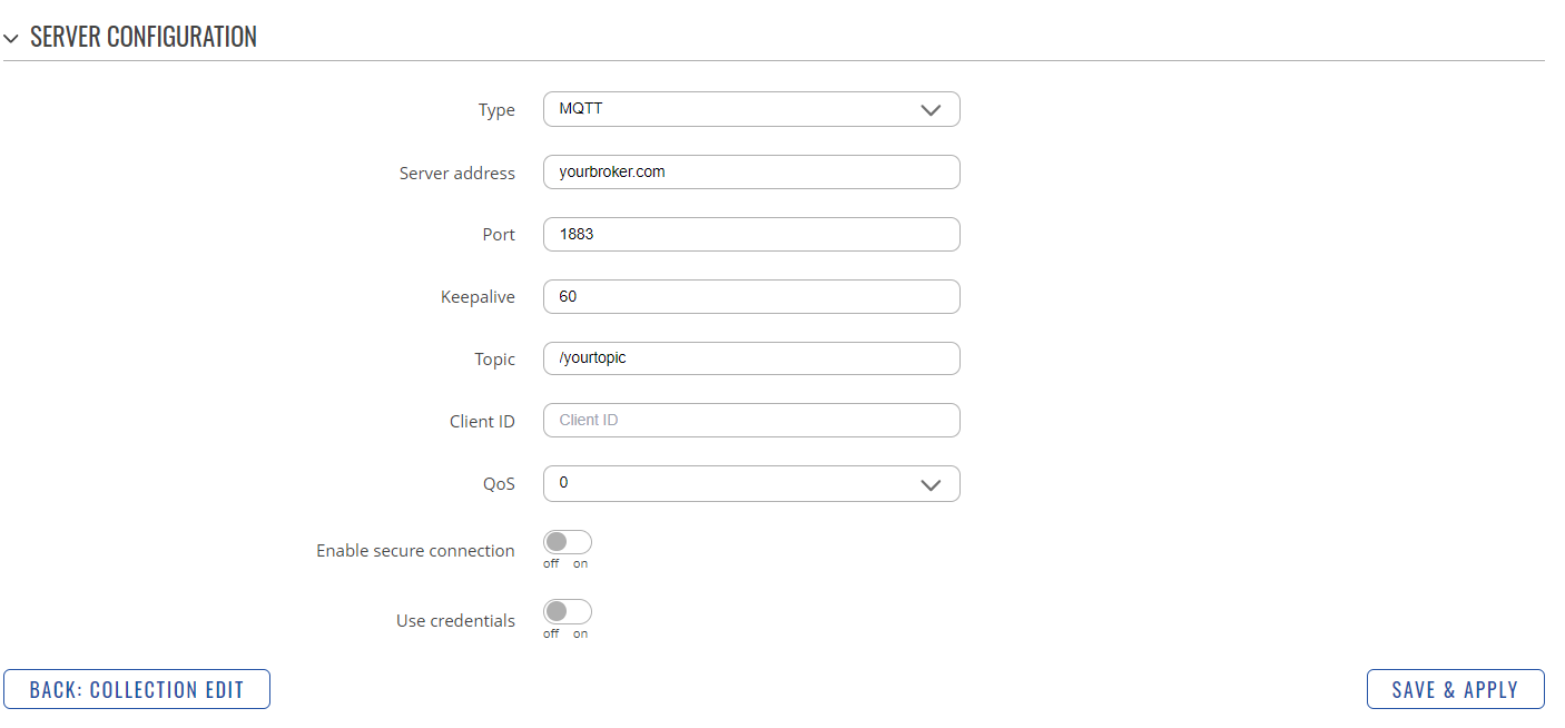

Next, on the server configuration page, select MQTT as the type and enter your broker’s information, such as server’s address, port number, topic, etc.

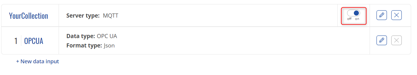

Make sure that the collection is enabled:
This should be enough to send OPCUA data to your MQTT broker periodically (period is configured in the collection’s advanced settings).
