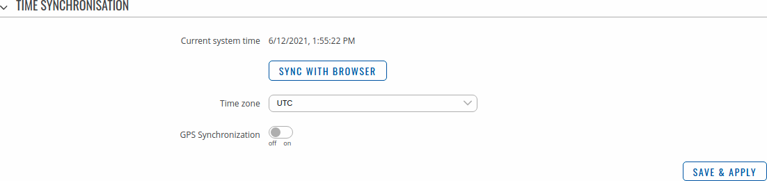

To sync time with GPS, this feature should be enabled in the Services → NTP → General:

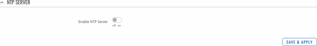

Then to create an NTP server, in the Services → NTP → NTP menu, enable the NTP Server option:
The devices will be able to sync the time with RUTX14 by using its IP address.
