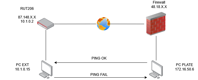

The VPN Tunnel is established, and I can do ping from PC behind my firewall to PC connected to router, but not reverse.
This is my network diagram:

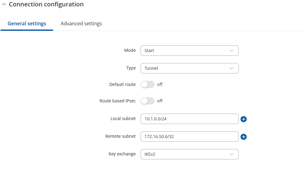

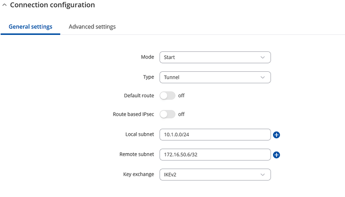

And the Teltonika configuration

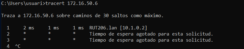

If I do a tracert from PC EXT to PC PLATE, stops on router:

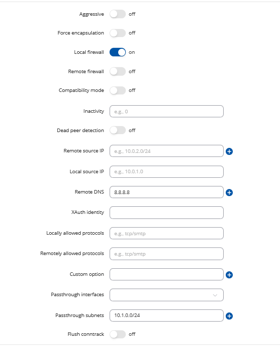

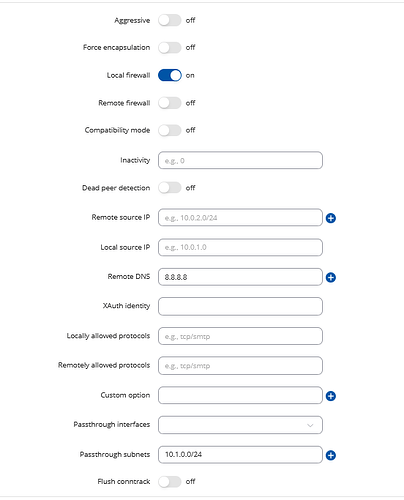

Retry after removing 10.1.0.0/24 from the Passthrough subnet list and restarting the tunnel.

removing passthrough doesn’t work, this is the iptables result:

I left the ping from 172.16.50.6 to 10.1.0.15 (work) and simultaneously did ping from 10.1.0.15 to 172.16.50.6 and didn’t work.
The solution was this:
I solved it by modifying a rule on our inbound firewall. I had only allowed inbound traffic. In the same rule, I also allowed outbound traffic from that server, and it worked.
