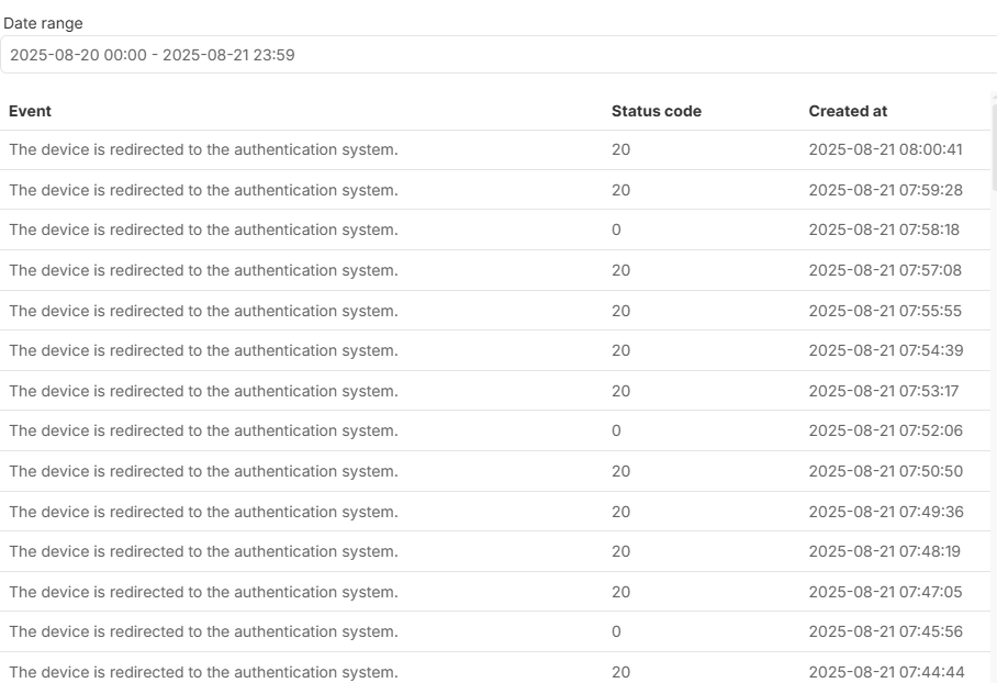

I have a RUT200 that has been connected and used on the RMS system. However, it keeps coming up with this message today:-
The device is redirected to the authentication system.
The modem is remote so i cannot make any changes the remote end.
Any help would be appreciated.

Could you please provide a screenshot of the logs you see on RMS?
