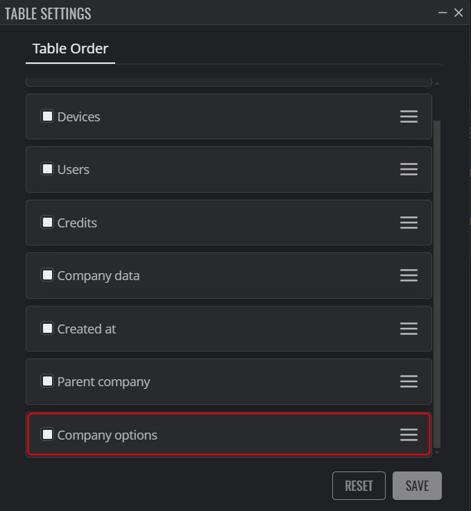

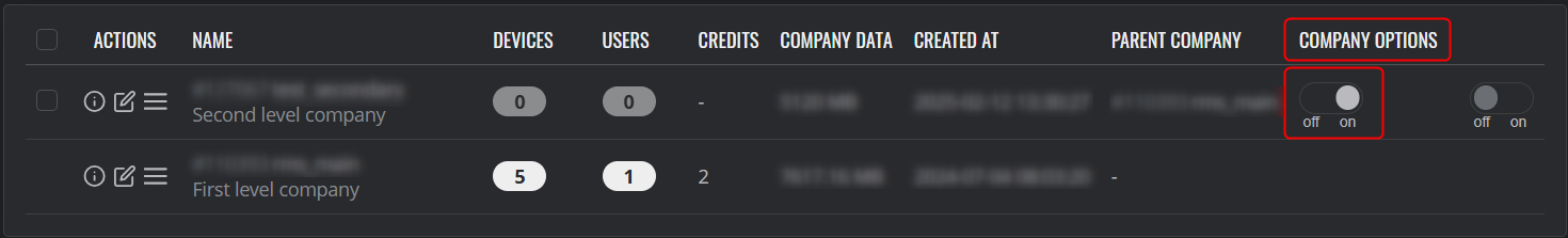

Do you see the options shown in the screenshot below in Administration → Companies?
Additionally, please ensure that Company options are present and selected in the Companies table settings:
If these options are missing, try resetting the table settings.
I hope this helps, and if you need further assistance, feel free to reach out.
Thank you, it was helpfull. I should reset the table settings.
