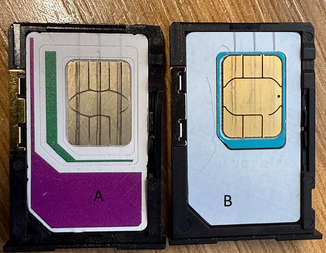

What does your sim look like: A or B below?

The SIM card looks like A in the picture.
