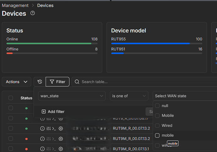

I would like to see if there were any of our devices that failed over to Mobile. The new RMS UI defaults to showing under Devices; Status, Device model & Device firmware. Are we able to add the Connection Type there also? We would like to see if connection type is either Mobile or Wired.
I found that you can use the Filter to show wan_state is “mobile” to show everything not on a Wired connection.
To create a custom preset in Page settings, please follow these steps:
  1. Click on Page settings and select Create new preset.
  2. Next to Parameters, click +Add.
  3. Choose Default parameters.
  4. Select the parameters you would like to display next to your device. To view the connection type, ensure you select Device connection type.
Please let me know if you need any further assistance!
