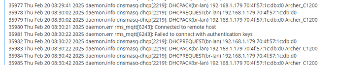

As I understand, the issue doesn’t occur during speed tests but only when using video streaming apps. Would it be possible to provide any logs in .txt format from System → Maintenance → Troubleshoot System log → Show section after the issue reoccurs?

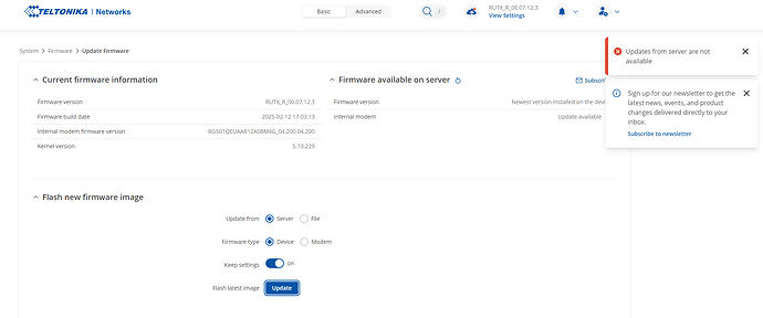

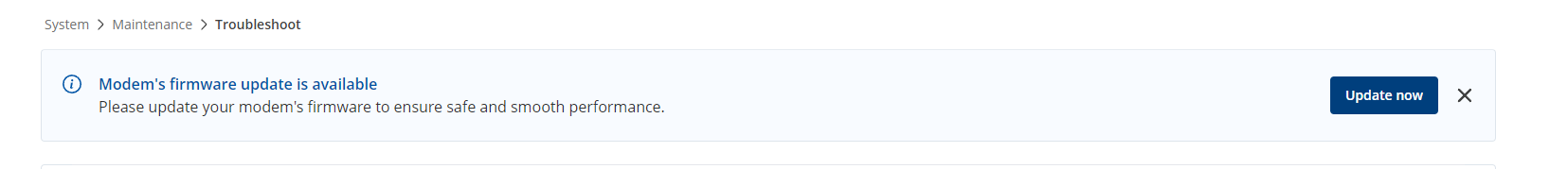

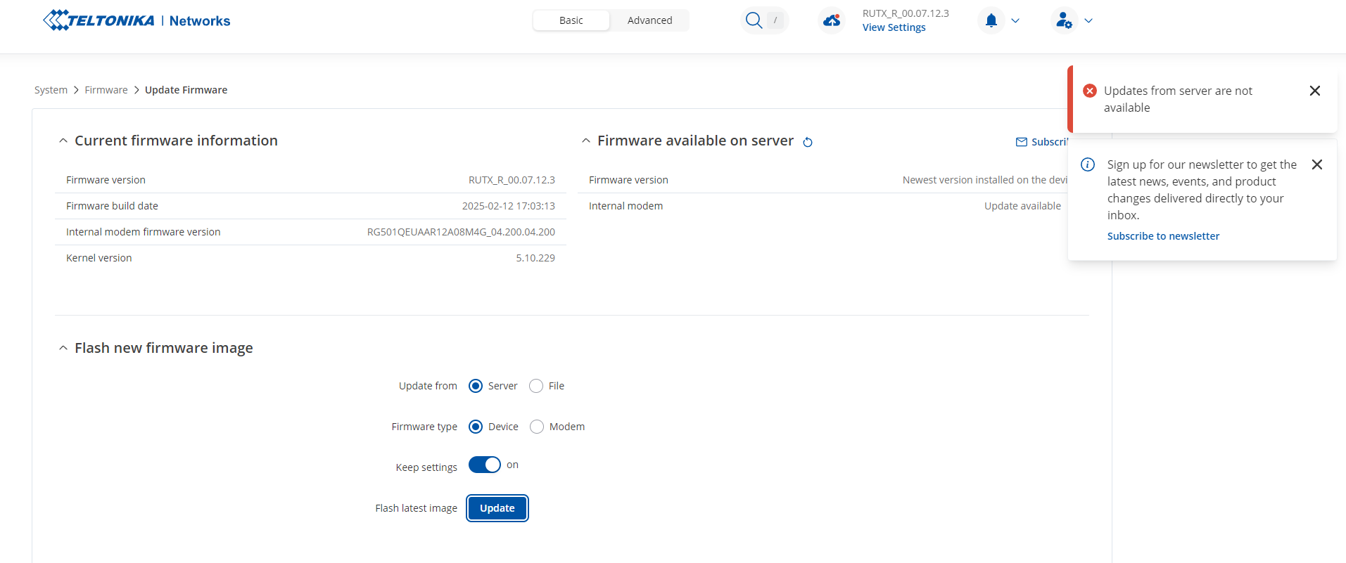

The latest software was installed yesterday. it shows one more install possible, but when i click on it i get error.
The available update is for the internal modem, so in this case, you should select Firmware Type – Modem and update it from the server.
Let me know if you need any further assistance.
Hi Martynas. Today we got again lagging action,
